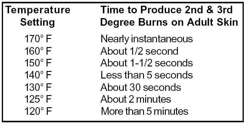

hausdok Posted June 21, 2007 Report Share Posted June 21, 2007 Hi All, The nifty AO Smith scald chart below was submitted by Brian Goodman, Columbus, MS. He didn't want me to credit him with submitting it. Too modest, I suppose. TIJ is about sharing. When folks share, we oughta thank 'em. Thanks Brian! You're a mensch! OT - OF!!! M. Image Insert: 126.38 KB Quote Link to comment Share on other sites More sharing options...
Brian G Posted June 21, 2007 Report Share Posted June 21, 2007 I ran across that somewhere in my surfing and kept it. I include it in the report whenever I find a high setting, and it seems to get peoples attention. To me the big jump is between 130 - 140, where the time to react and get away drops from 30 seconds (lots of time) to less than 5 seconds (very little time). I did one Monday that was set at 160°...ouch! And Mike, thanks for the tip on getting the degree symbol to come up. I love it. Brian G. Girlfriends Can't Be Too Hot, But Water Can [:-hot] Quote Link to comment Share on other sites More sharing options...

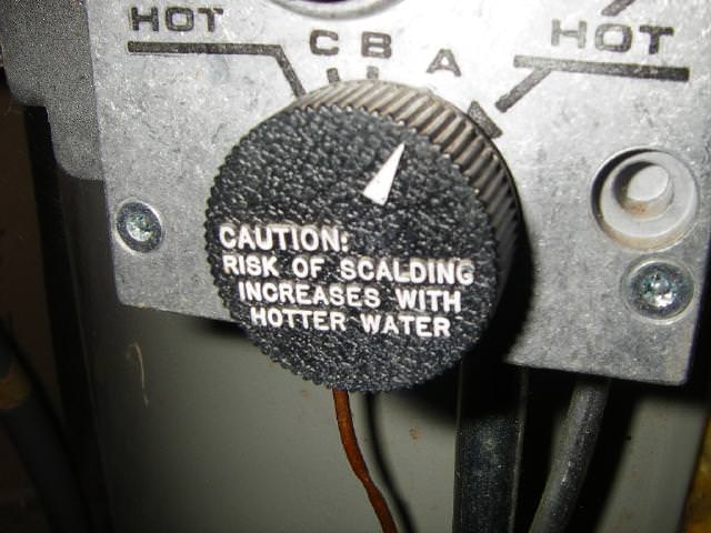

homnspector Posted June 26, 2007 Report Share Posted June 26, 2007 Be sure to share this warning found on a State brand water heater with all your clients, especially those with very low IQ.[:-dunce] Image Insert: 53.72 KB Quote Link to comment Share on other sites More sharing options...
