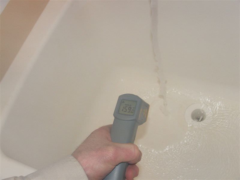

charlie Posted January 14, 2006 Report Share Posted January 14, 2006 I found this temp in a home and the seller thought it was just fine! Download Attachment: hot water 082.jpg 41.55 KB Link to comment Share on other sites More sharing options...

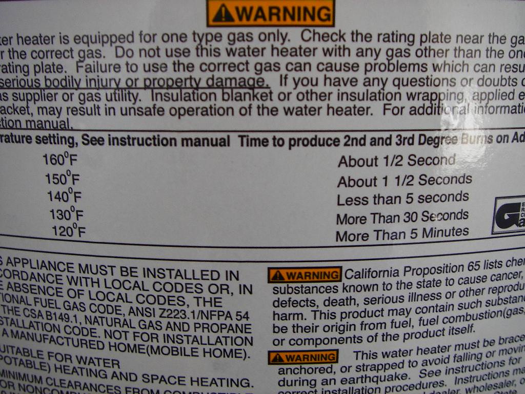

homnspector Posted June 12, 2007 Report Share Posted June 12, 2007 Found this sticker on a water heater today, may shed some light on this or at least provide ammo. Download Attachment: Scalding.jpg 157.44 KB Link to comment Share on other sites More sharing options...
