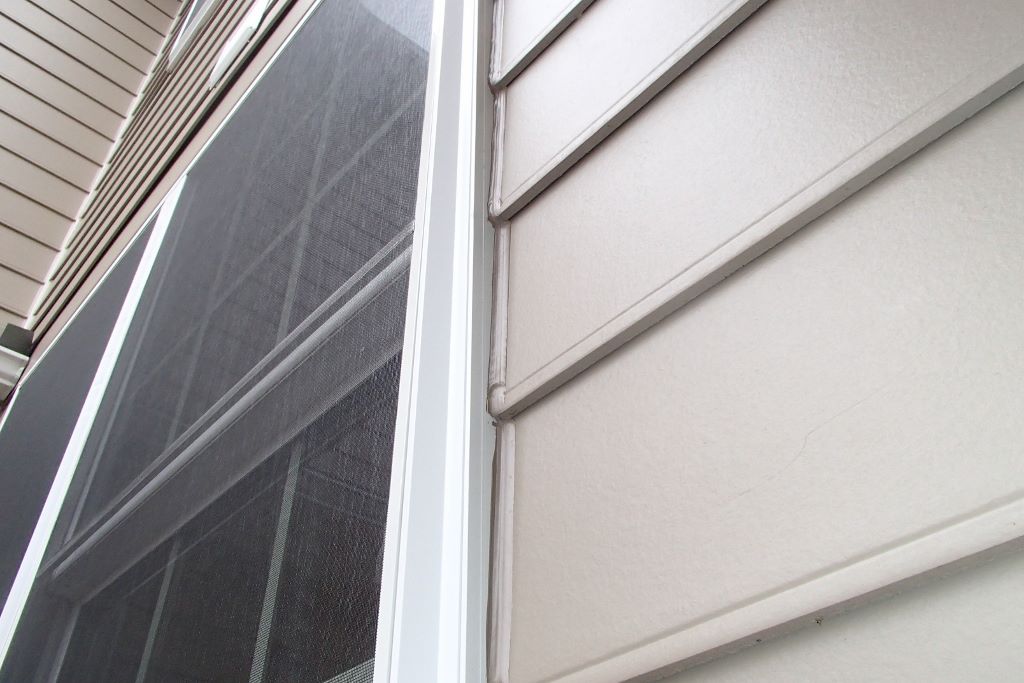

mjr6550 Posted November 6, 2017 Report Share Posted November 6, 2017 I don't see much fiber cement or hardboard siding in my area. Is this Hardiplank? The beading does not look like their style. I don't think is matches LP Smartside either. Is it one of those or something else? Quote Link to comment Share on other sites More sharing options...
Jim Katen Posted November 6, 2017 Report Share Posted November 6, 2017 Hardiplank makes a siding with that profile. Choose a discreet area and probe the siding to see what it's made from. If it's fibercement, then it's probably Hardiplank's "beaded smooth" product. Quote Link to comment Share on other sites More sharing options...
mjr6550 Posted November 7, 2017 Author Report Share Posted November 7, 2017 Thanks Jim. I don't recall seeing the beaded Hardiplank, but I looked at photos of it before posting. The Hardiplank bead looks like it may be more rounded and the groove looks more defined or deeper than this siding. Are you familiar with the beaded Hardiplank? (sounds like I'm talking about a rare breed of bird). Quote Link to comment Share on other sites More sharing options...
Jim Katen Posted November 7, 2017 Report Share Posted November 7, 2017 I've only seen it once in the wild. The bead might have been more defined, but it's hard to say. Lighting can make a big difference. Quote Link to comment Share on other sites More sharing options...
BADAIR Posted November 8, 2017 Report Share Posted November 8, 2017 (edited) possibly certainteed line durapress weatherboard www.sidingsolutions.com/infopages/WBContractorGuide.pdf Edited November 8, 2017 by BADAIR Quote Link to comment Share on other sites More sharing options...
mark parlee Posted January 16, 2018 Report Share Posted January 16, 2018 Getting in here late. That is Hardie Plank Smooth Beaded Lap. Quote Link to comment Share on other sites More sharing options...
