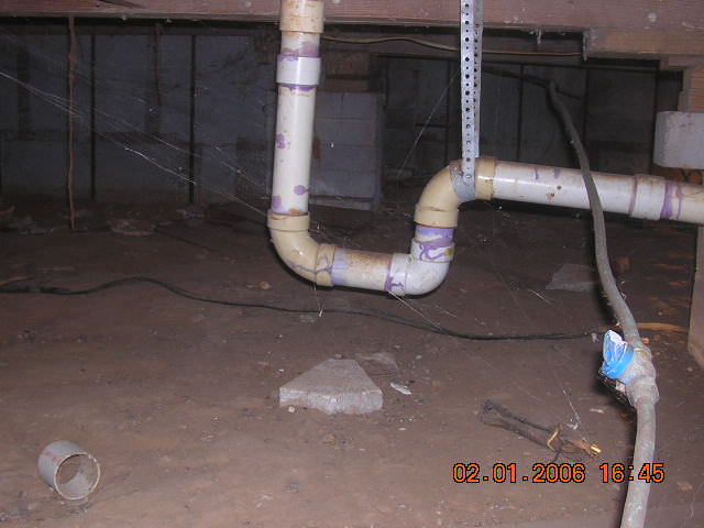

rlskfoster Posted February 2, 2006 Report Share Posted February 2, 2006 Are these traps functional or is this a total waste of glue and couplings? I have never seen anything like this and I don't know why it would or would not function as a trap. Plumbing is not a strong suit of mine. Thanks, Buster Download Attachment: Trimble Stull 060.jpg 78.5 KB Link to comment Share on other sites More sharing options...
Brian G Posted February 2, 2006 Report Share Posted February 2, 2006 I think it would function, assuming it's vented. However, there's this from the 2003 IRC: P3201.2 Trap seals and trap seal protection Traps shall have a liquid seal not less than 2 inches (51 mm) and not more than 4 inches (102 mm). There's one exception, for floor drains. I'd say what you've got there may hold more than 4 inches, but you'd know better than I and it seems like sort of a fine point anyway. Any plumbing guru's want to weigh in? Brian G. More Familiar With "Tender Traps" [:-eyebrow Link to comment Share on other sites More sharing options...
Richard Moore Posted February 2, 2006 Report Share Posted February 2, 2006 Without knowing where the "trap arm" goes to (exits picture right) or the slope (tough to tell from a photo) there are a couple of IRC codes that might apply. The first is P3105.1 which says that the distance from the trap weir to the vent fitting (basically the trap arm length) can be no more than 6' for an 1½" pipe (8' for 2" pipe). The second is P3105.2 which, interpreted, says that the total fall or downslope in the trap arm cannot exceeed one pipe diameter (1½"? in this case) I believe both the above are intended to ensure proper venting and prevent siphoning. There is also the "no more than 24" rule for the vertical distance from the fixture to the trap. If that's a shower or tub it may be OK. If it's from a sink then not. Link to comment Share on other sites More sharing options...
rlskfoster Posted February 2, 2006 Author Report Share Posted February 2, 2006 It is 2 inch pvc and if I remember right it they would probably both tie to the main drain within 8 foot. It is more than four inches, I would say about six to eight inches. One of them was off a tub and the other was from a washer box so it would definately exceed the 24 inch rule. The only vents in this house came from the toilets. I had written up a couple of s-traps under sinks but I forgot about venting the other drains. Could you put air admittance valves somewhere? That was what I suggested for the sink traps. This was an old house out in the country and had been remodeled many times over. Most of it incorrectly. Thanks for the good info on plumbing. Buster Link to comment Share on other sites More sharing options...
Paul MacLean Posted February 2, 2006 Report Share Posted February 2, 2006 It might function as a trap, but it's not going to be self-cleaning. Link to comment Share on other sites More sharing options...
RobC Posted February 2, 2006 Report Share Posted February 2, 2006 Buster, I believe your first impression as being a 'total waste of glue and couplings' is correct. Firstly, a plumbing waste trap is a fitting with specific engineering to control waste in a specified manner. There are numerous criteria that must be met. For example, the tail piece and trap arm must be within a certain length. The piping must slope within a certain tolerance usually 1/4": 1'-0", that's to ensure we move solids to their destination point etc. I don't see this installation as meeting any of the above criterias. You are correct "it is a waste..." I particularly like the tight 90 [:-taped] Link to comment Share on other sites More sharing options...
