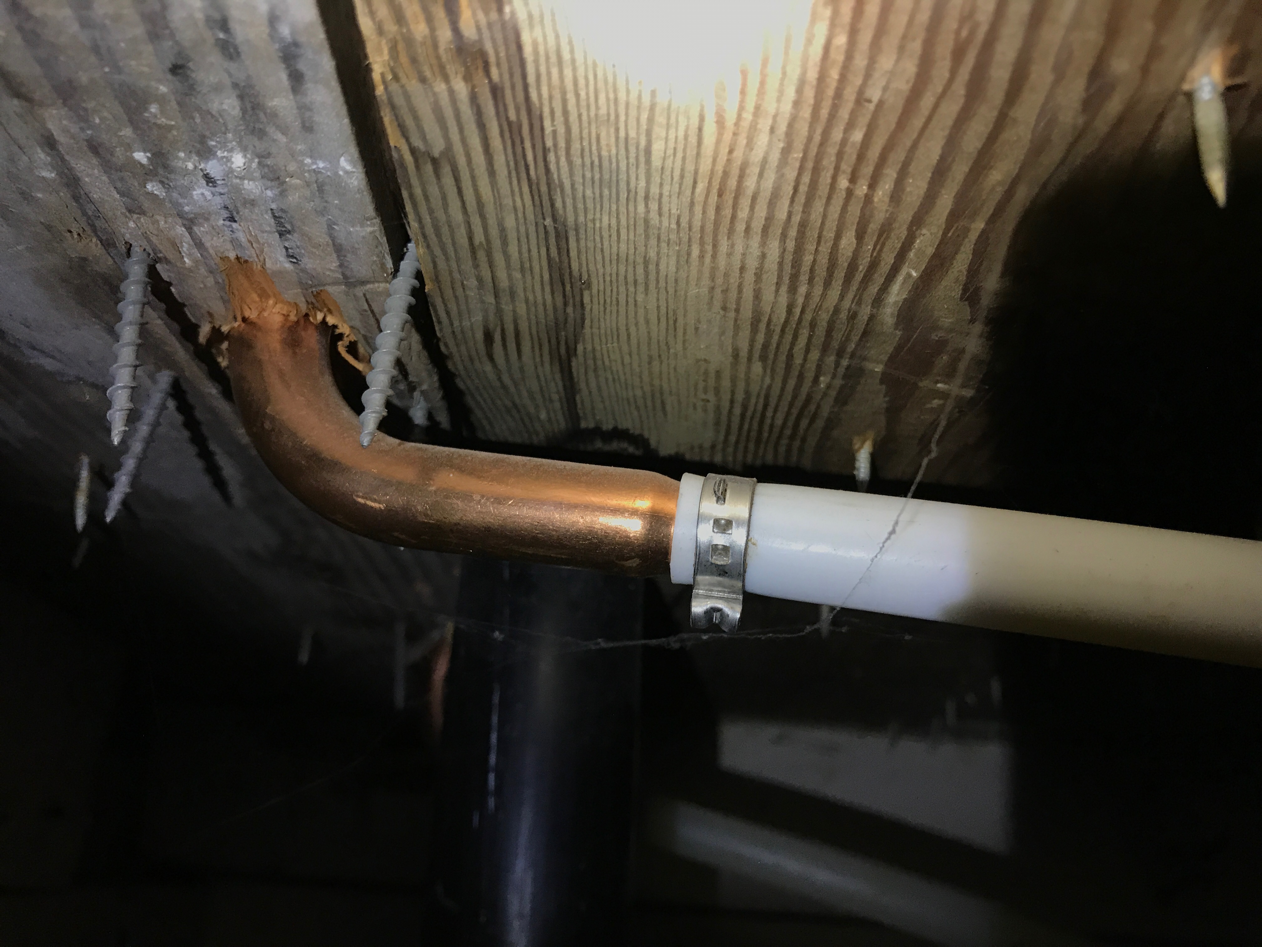

CNewhouse Posted January 30, 2021 Report Share Posted January 30, 2021 My gut says this isn't right. There's no transition piece between the copper and PEX, and it doesn't look like the tapered copper end is barbed like a proper male crimp fitting would be. Am I wrong? I can't recall ever seeing copper taper into PEX like this. Quote Link to comment Share on other sites More sharing options...
Bill Kibbel Posted January 30, 2021 Report Share Posted January 30, 2021 It looks like a copper stub-out elbow, specifically for transitioning to PEX. Quote Link to comment Share on other sites More sharing options...
Bill Kibbel Posted January 30, 2021 Report Share Posted January 30, 2021 https://www.grainger.com/product/ZURN-PEX-Copper-Elbow-Stubout-10A610 Quote Link to comment Share on other sites More sharing options...
CNewhouse Posted January 30, 2021 Author Report Share Posted January 30, 2021 That is does. Glad I asked. Thanks Bill. Quote Link to comment Share on other sites More sharing options...
