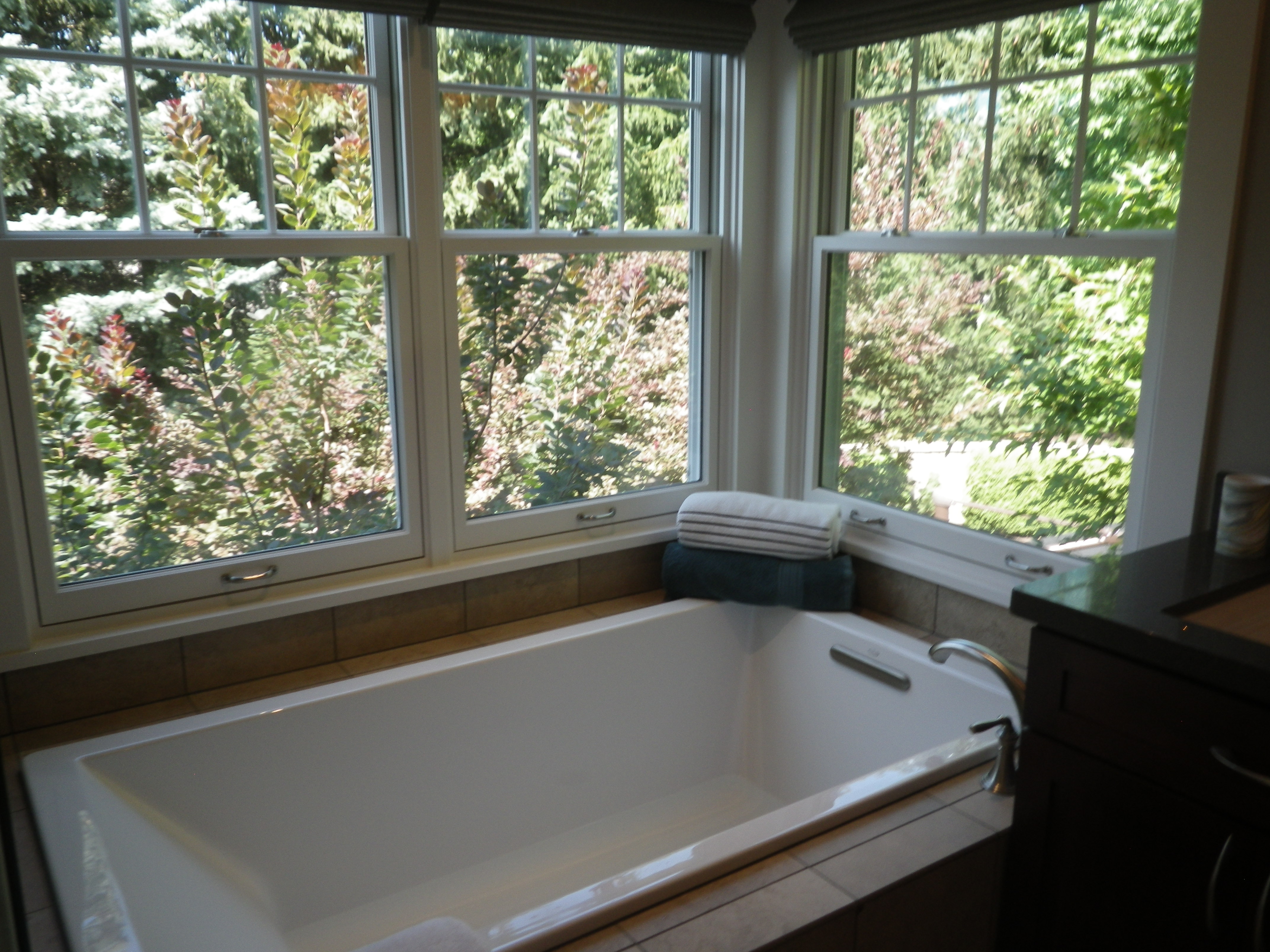

Jerry Simon Posted July 31, 2022 Report Share Posted July 31, 2022 Should these be glazed with tempered glass? Quote Link to comment Share on other sites More sharing options...
adair Posted July 31, 2022 Report Share Posted July 31, 2022 (edited) yes @ all panes only 60" AFF – Above Finish Floor or 60" away from tub shower edge wouldn't Edited July 31, 2022 by adair Quote Link to comment Share on other sites More sharing options...
Jim Katen Posted August 1, 2022 Report Share Posted August 1, 2022 My version of the code reads 60" above any standing or walking surface, which would include the tub deck. (IRC 308.4.5) Quote Link to comment Share on other sites More sharing options...
