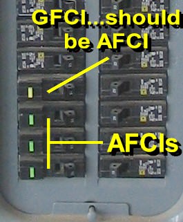

Richard Moore Posted May 21, 2006 Report Share Posted May 21, 2006 This really bugged me today. Download Attachment: 0033gfciafci.jpg 34.18 KB New construction, 3600sf 5br/4ba home by one of the major builders. The labeling was clearly marked that the four bottom left breakers all served bedrooms. The fourth up was clearly marked master bedroom. At first I thought it was just an off-color test button but, no...once I had the cover off it was clearly marked as a GFCI breaker, clearly physically different from the AFCI breakers, and it took my GFCI tester (not AFCI) to trip the outlets in the master bedroom. Keep in mind that I have never seen a GFCI breaker in any of the panels in other new homes in this large sub-division (all receptacle GFCIs). I guess I'm having a hard time with the sparky (or probably his apprentice} not noticing or not caring that it was clearly a different and wrong breaker type. Ok...rant over...get back to your weekends. Link to comment Share on other sites More sharing options...

inspectort Posted May 24, 2006 Report Share Posted May 24, 2006 Richard, Clearly wrong. That GFCI breaker might have been intended to serve a whirlpool tub, they may have just got their branch circuts mixed up in the panel and put the wrong wires under the wrong breaker. However they should have checked it. Just a thought. Troy Link to comment Share on other sites More sharing options...
Richard Moore Posted May 24, 2006 Author Report Share Posted May 24, 2006 It's a good thought Troy, but it doesn't work in this case. I've done a number of new homes by this major builder in this huge development. Those that have had jetted tubs all had the GFCI protection at a receptacle in the master bath closet. None of them have had any GFCI breakers at the panel. So...no, I don't see that as a mitigating excuse. I'm guessing it's the same guy who constantly crushes or disconnects the heating ducts in the crawl. Grrrrr. But...I'm over it now. [:-spin] Link to comment Share on other sites More sharing options...
