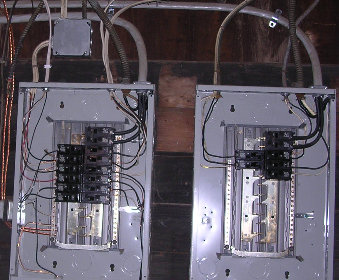

PAbernathy Posted February 15, 2007 Report Share Posted February 15, 2007 Gary, I do find some others issues in that panel if you do care to know what they are...but I will address your question. 1.) Basically the understanding of that " Big Honkin Copper" is the miscoception to its function if it is going to the GEC. The only real purpose in that connection is Lightning, High Voltage Surge and High Voltage Shunts for a lack of a better term and to aid in the POCO as well IF this is going to the GE.........it is very important to know that it plays no role in the fault or OCPD function of the system if again it is going to the GE. I will try to keep this basic.........the function of the grounded conductor is to create the return path for the electrons to low and is a low impedance path as such...the earth is not....while it could flow on it during a parallel environment it is not a good conductor and plays no role in protecting the inside components or personal safety...just needed to get that out of the way. However the "Grounded" conductor itself plays a very important role in allowing the OCPD to function properly. (D) Grounding Electrode Conductor Taps. Where a service consists of more than a single enclosure as permitted in 230.40, Exception No. 2, it shall be permitted to connect taps to the grounding electrode conductor. Each such tap conductor shall extend to the inside of each such enclosure. The grounding electrode conductor shall be sized in accordance with 250.66, but the tap conductors shall be permitted to be sized in accordance with the grounding electrode conductors specified in 250.66 for the largest conductor serving the respective enclosures. The tap conductors shall be connected to the grounding electrode conductor in such a manner that the grounding electrode conductor remains without a splice. Now....Section 230.40 ex. 2 is what firstly would permit this installation. Now personally I look at this picture and ( not knowing where exactly the stranded copper conductors on the left are going ) feel it should have a bond between each panel OTHER than using the "Grounded" connection at the meter enclosure....but over the years that section of the NEC has been so screwed up it is not until 2008 that it is being revamped.... The NEC says that all enclosures likely to carry fault current path should be tied together so the debate is...are they tied together via the "Grounded" conductor at the meter enclosure on this type of setup....probably are and many will argue that they are......personally I like to see a bonding jumper between these enclosures as they may be separate in function they share a common service and a common fault current path back to the source. Man....this is hard to explain in type....this is why I said....anyone feel free to call me 540-607-0116 if better explanations are needed....I get calls from all over the country daily. So the arguement is......is it ok to run the GEC to the Meter or only the (1) service panel in question here....based on current language it does not disallow it. However the other issues come into play here is are the water piping systems different...are they separated....and if so is that piping system for the panel on the RIGHT tied properly back to it's own panel..... very hard to tell with these pictures and I hope this has not been confusing...please by all means call me if it is because I am typing it between many phone calls. Link to comment Share on other sites More sharing options...
PAbernathy Posted February 15, 2007 Report Share Posted February 15, 2007 I would be very interested in knowing where those " Big Honkin Conductors" go to within the system itself so we can look at it furthur. Link to comment Share on other sites More sharing options...

PAbernathy Posted February 15, 2007 Report Share Posted February 15, 2007 Thanks Chicago.....yeah gotta watch out for that spam... I also wanted to explain why I like to see a bond between these enclosures..... 1.) if the "Grounded" conductor comes loose within the enclosure the bonding path to the second panel becomes a pathway for the fault current and still allow the operation of the OCPD..... In the image posted alot depends on the design of the system when it comes to bonding it...as if each level is separated by lets say metal piping and a non-metalic jumper gets between these systems...then you would need it's own individual bond back to it's own enclosure.....many variables in this setup and we need to know all the factors involved. Lastly I think the 2008 NEC will clear this up alot but many people also believe that in the setup you have shown it would require a seperate GE from the second enclosure to the GEC as well....but it is looked at in many ways but factually they are tied together at the meter enclosure...so they are technically tied together conductivly at that point. Link to comment Share on other sites More sharing options...
ozofprev Posted February 15, 2007 Report Share Posted February 15, 2007 Paul, One went to a rod, the other to the plumbing. The plumbing system for the duplex is combined - but that gives me something else to think about in the future. Your explanation is clear. I was told that things would be different in a heavy lightning area, but not why it is ok otherwise. Now, it makes perfect sense. I can't believe you have time to answer calls. I won't be bothering you, but your helpful attitude is greatly appreciated. Originally posted by PAbernathy I would be very interested in knowing where those " Big Honkin Conductors" go to within the system itself so we can look at it furthur. Link to comment Share on other sites More sharing options...

PAbernathy Posted February 15, 2007 Report Share Posted February 15, 2007 (2) Buildings of Multiple Occupancy In buildings of multiple occupancy where the metal water piping system(s) installed in or attached to a building or structure for the individual occupancies is metallically isolated from all other occupancies by use of nonmetallic water piping, the metal water piping system(s) for each occupancy shall be permitted to be bonded to the equipment grounding terminal of the panelboard or switchboard enclosure (other than service equipment) supplying that occupancy. The bonding jumper shall be sized in accordance with Table 250.122. The INTENT is this... Section 250.104(A)(2) recognizes that the increased use of nonmetallic water piping mains can result in the interior metal piping system of a multiple-occupancy building to be isolated from ground and from the other occupancies. Therefore, the water pipe is permitted to be bonded to the panelboard or switchboard that serves only that particular occupancy. The bonding jumper, in this case, is permitted to be sized according to Table 250.122, based on the size of the main overcurrent device supplying the occupancy. So in your case it is a common water piping system and could go back to the common GEC that is running to the first panel enclosure. But it is important for those out there who run into a system where the piping is seperate that this must be taken info considering in the information I posted above. Gary if you or anyone ever is in the middle of an inspection and has a question please call......I carry my phone with me everywhere when doing seminars or in the ditch....Sometimes I have a hard time typing what I am trying to convey and it works much better if someone is really questioning something they can always give me a call.... However again I would like to see a bond between those panels to create a loop for fauly current in case one becomes disconnected but what are the odds... Link to comment Share on other sites More sharing options...

PAbernathy Posted February 16, 2007 Report Share Posted February 16, 2007 Felt I should explain HOW it would be done IF I was the electrical contractor doing it... 1.) The panels are being Back-fed so they need to have a support designed to hold in the breaker but then again I would not have done a back fed here. I would have ran a single common GEC to the Ground Rod(s) and ran it to the FIRST enclosure....then I would have run a TAP out of the second enclosure and connected it to the GEC going into the first enclosure.....but thats me... Thats what is so messed up about this section of the NEC...and the 2008 NEC clears it up ALOT..... Basically most people will simply run to the first enclosure OCPD since they are technically on the same single service ( ignore the fact it has (2) meters...because of the location ) and then simply bonded from one enclosure to the other...but they better make sure the bonding jumper is sized right......thats where they mess up. Since the ability to TAP is explained in the NEC as optional no one really can STICK their finger on the exact intent as in the end it is all considered connected at the meter enclosure in this installation......however I happen to think a bond connection between enclosures is needed......and from what I can gather is not in place. Now...since we are only talking a Ground Rod in your images...a # 6 CU is all that would be needed to the Rods....so technically if you wanted to do the tap method...simple bring the # 6 CU into the first panel and then run a # 6 CU from the second panel out and SPLIT BOLT it to the GEC going into the first panel....the one going into the FIRST panel needs to be continuous ( with exceptions ) but the tap to it from the second one does not need to be continuous to the rod...that is why the split bolt is allowed.... Now the bond to the water pipe is done here technically since it is all the same service and they share the water piping system...anything other would create a parallel path and is not really needed...so that is fine to the first panel...remember electrons are trying to get to the source...and in this case...the source is shared...so it's all good.... Link to comment Share on other sites More sharing options...
