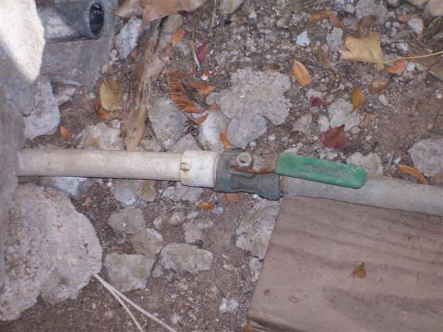

tbird Posted February 17, 2007 Report Share Posted February 17, 2007 Hey guys, This is a head scratcher. These people use PVC pipe for running natural gas lines underground to outbuildings and above ground in the outbuildings. They painted the exposed pipe black. This is the first I have ever seen this. My instinct is to run. What's yours? Download Attachment: PVCGas.JPG 89.86 KB Download Attachment: PVCGasBlack.JPG 78.84 KB Link to comment Share on other sites More sharing options...
Bill Kibbel Posted February 17, 2007 Report Share Posted February 17, 2007 The only plastic pipe (that I know of) that can be used for NG is medium density polyethylene (PE). It is always yellow and labelled with "Gas" and "PE". I think it can only be used to a building. Link to comment Share on other sites More sharing options...
