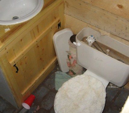

mridgeelk Posted May 5, 2007 Report Share Posted May 5, 2007 This bath floorplan was in two separate rustic cabins built about ten years ago inspected today, by the way the "shower stall" is to the left of the sink. I believe that this crackpot layout is clear evidence that in no way could this have been passed by a plumbing inspector in the State of Colorado. Any opinions? Ed Download Attachment: Fulstone three 090.JPG 48.79 KB Link to comment Share on other sites More sharing options...
Jim Katen Posted May 5, 2007 Report Share Posted May 5, 2007 Originally posted by mridgeelk This bath floorplan was in two separate rustic cabins built about ten years ago inspected today, by the way the "shower stall" is to the left of the sink. I believe that this crackpot layout is clear evidence that in no way could this have been passed by a plumbing inspector in the State of Colorado. Any opinions? Ed I don't know anything about the requirements of Colorado. The only thing I can tell from the picture is that the lav lacks the required 21" clearance in front of it per the IRC. - Jim Katen, Oregon Link to comment Share on other sites More sharing options...
