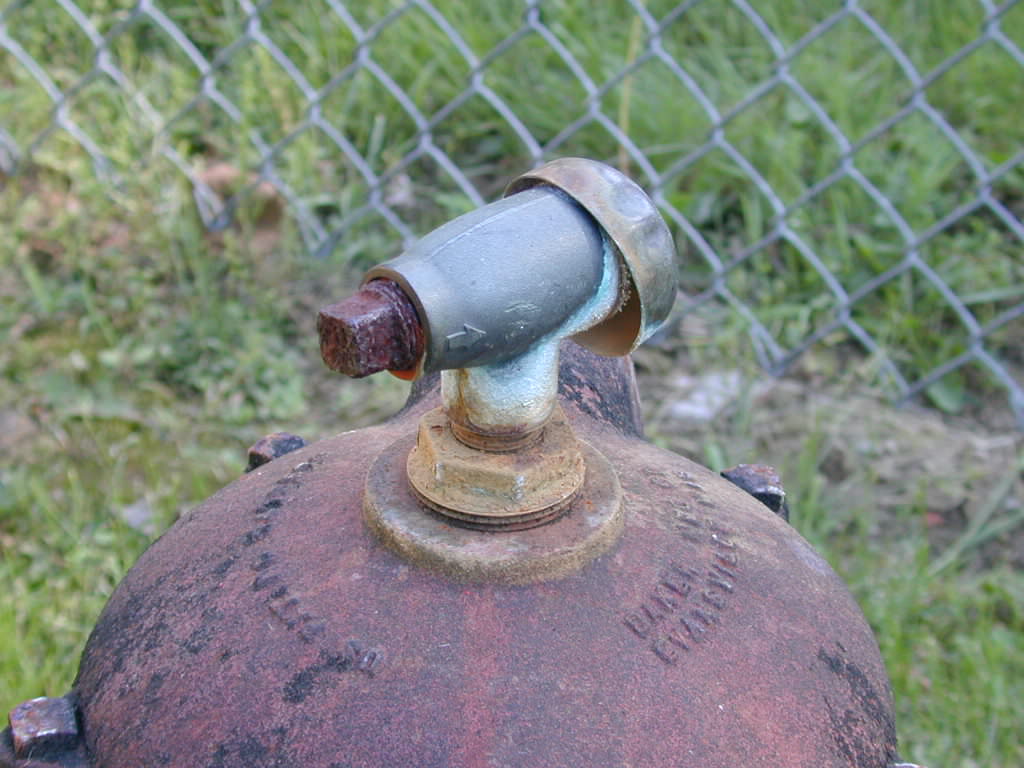

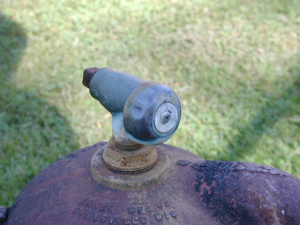

Kyle Kubs Posted June 12, 2007 Report Share Posted June 12, 2007 I've never seen one of these before. It's screwed right into a tapping at the top of the well head. The buyers stated that during a previous visit to the house it was spraying water almost continuously and that the area around the well casing was saturated. Anyone know what this is? Download Attachment: well_fixture.jpg 171.97 KB Download Attachment: well_fixture2.jpg 173.75 KB Quote Link to comment Share on other sites More sharing options...
ghentjr Posted June 12, 2007 Report Share Posted June 12, 2007 It is a diffuser. It allows overflow water from normal pressure to be released close to the well head without making a stream of water. This could be considered a true artesian well if water flows from the well head on a regular basis. Quote Link to comment Share on other sites More sharing options...

StevenT Posted June 13, 2007 Report Share Posted June 13, 2007 I guessed some type of pressure relief valve, by the difusser bell at the end. But what is the plugged inlet for? Additional sources, or, installing in alternate position? Quote Link to comment Share on other sites More sharing options...
Neal Lewis Posted June 13, 2007 Report Share Posted June 13, 2007 That cap looks like it's meant for a hand to grab and turn. Most valves that I see on the top of well heads look different than that. A well contractor told me if water is coming out of that valve from an artesian condition, it could cause a problem with freezing and damaging the well head. Quote Link to comment Share on other sites More sharing options...
ghentjr Posted June 14, 2007 Report Share Posted June 14, 2007 It appears to be an older valve that was modified for this purpose. I have seen many different variations of home made fittings used to control the overflow. Most, however, just have a hose hanging over the side. This may have been a flow valve of some type as is indicated by the arrow. But if you look close there does not appear to be enough strength in the cap to be used as an active off and on. There are very few artesian wells that actually do freeze when they discharge. The ground water being around the low to mid 50's keeps the air in the casing warm enough. Some do build up a little ice from time to time but I have never seen one freeze solid. Quote Link to comment Share on other sites More sharing options...

StevenT Posted June 14, 2007 Report Share Posted June 14, 2007 There's a well like that at the local Marine Post. Folks fill bottles all day. I was told that water originated in Canada. Used to fill the coolers for my worksites there. Anyway, To me it looks like a diffuser, not a turn handle. I suspect that the plugged end at some point was (or could be) the feed to that tank. Or is there another feed somewhere that can't be seen in the pic? Quote Link to comment Share on other sites More sharing options...
