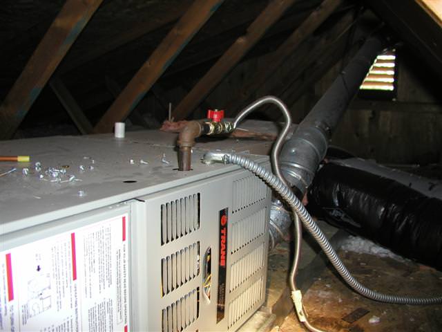

Robert Jones Posted June 14, 2007 Report Share Posted June 14, 2007 Hello everyone. Can someone point me in the direction of the code for installing a natural gas furnace in an attic space. Ran into one today that did not provide a light fixture and I am sure other items are not correct. Thank-you. Image Insert: 48.43 KB Quote Link to comment Share on other sites More sharing options...
hausdok Posted June 14, 2007 Report Share Posted June 14, 2007 Hi, Rename your photo without the parenthesis and then re-post it and it will display. OT - OF!!! M. Quote Link to comment Share on other sites More sharing options...
Robert Jones Posted June 14, 2007 Author Report Share Posted June 14, 2007 I am sorry but everytime I try to rename my pics it changes the file and is unusable. Not sure why that is happening now, it is a recent issue. Is there an installation code for these furnaces in the attic area? Thanks Mike Rob Quote Link to comment Share on other sites More sharing options...
hausdok Posted June 14, 2007 Report Share Posted June 14, 2007 From CodeCheck HVAC Email me the photos at hausdok@msn.com and I'll fix it. You want IRC 1305.1.3 or UMC 908.0 It's supposed to have a light with the switch at the access door. 1305.1.3.1. You know, you can order CodeCheck HVAC right here at TIJ's online store. Just click on the menu bar above and then on Code Check. OT - OF!!! M. Quote Link to comment Share on other sites More sharing options...
