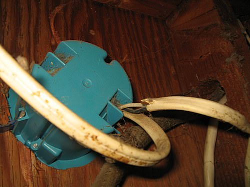

Chris Bernhardt Posted June 30, 2007 Report Share Posted June 30, 2007 Can two cables enter a plastic box through one knock out? If the tab is too weak to be a sufficient strain relief and the cable can be pulled out is there certain fix that should be done? Image Insert: 45.92 KB Chris, Oregon Link to comment Share on other sites More sharing options...
Jim Katen Posted June 30, 2007 Report Share Posted June 30, 2007 Originally posted by Chris Bernhardt Can two cables enter a plastic box through one knock out? I don't know. You'd have to ask Carlon that one. They get to decide. I suspect they'll object. First of all, there are plenty of other tabs through which the second cable can pass. Second, the tab can only grab one cable so the second will always be able to slip in and out. If the tab is too weak to be a sufficient strain relief and the cable can be pulled out is there certain fix that should be done? If the cable were secured within 12" of the box as was supposed to have been, that wouldn't be a problem. - Jim Katen, Oregon Link to comment Share on other sites More sharing options...
