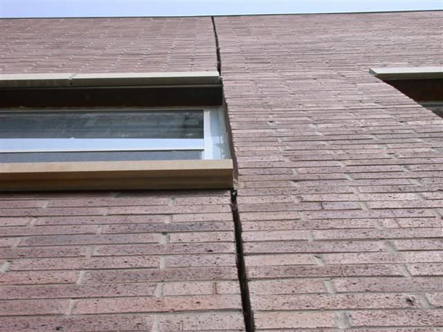

chicago Posted September 6, 2007 Report Share Posted September 6, 2007 What is wrong here? Image Insert: 67.87 KB Quote Link to comment Share on other sites More sharing options...
kurt Posted September 6, 2007 Report Share Posted September 6, 2007 They didn't finish the expansion joint, and they should have figured out some place better to put the window than on the joint(?) Quote Link to comment Share on other sites More sharing options...
Brandon Chew Posted September 6, 2007 Report Share Posted September 6, 2007 Do you have a closeup pic of the lintel at the top right corner of the window? The location of that expansion joint may be ok if they detailed this area properly. The lintel and the brick to the right of the window need to be able to move separately from each other. See figure 6 on page 5 of BIA technote 18A: http://www.brickinfo.org/BIA/technotes/t18a.pdf Quote Link to comment Share on other sites More sharing options...

kurt Posted September 6, 2007 Report Share Posted September 6, 2007 Brandon's point is well taken; if the lintel detail isn't correct, it's a leaker, plain & simple. This being Chicago, w/a window where it shouldn't be, and an unfinished joint, it's clear this is a very loose end, and no one has even thought about it a tiny bit. Lots of head scratching from one end, lots of assurances that everything will be fine from the other end...... I'd run. Quote Link to comment Share on other sites More sharing options...

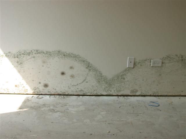

chicago Posted September 6, 2007 Author Report Share Posted September 6, 2007 Not drinking,but began seeing pretty colors around streetlights when I licked this off the wall behind that section. Image Insert: 28.51 KB Does it matter that it was daytime? Seriously though,I did find it a strange location for the joint and mold was all over the bottom 18 inches of drywall in the middle of the garden unit. My client is moving to the third floor,but I could not resist entering the open door in the name of looking for the main water shutoff. P.S Les thanks for the link. Scott what about Bob? should have been the standard response I was not sure if that window location was allowed,and how important the expansion joint is at this later stage of construction. That mold is either from an open set of windows during last weeks storm or the lack of expansion joints as far as I can tell. Quote Link to comment Share on other sites More sharing options...
