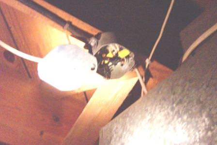

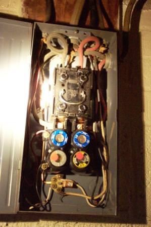

kasterko Posted January 15, 2008 Report Share Posted January 15, 2008 A 1950's home. This panel box is being used as a subpanel. The fuses are labeled as controlling the furnace, pump, "appl" and "gar/disp". This panel is feed, by what looks like SE cable, from a newer 150 main service panel with breakers. This subpanlel has no grounding wires in it. The junction box picture (poor) is where one of the circuits from the subpanel connects to a romex cable feeding the furnace and the grounding wire from the romex is connected to the junction box with a small green metal clip. The junction box was not grounded to anything I could see. I'm pretty sure disposals, furnace fans, etc. need to be grounded. So I believe it is not wired correctly. Anyway, this confused me. Many things do. I wrote it up as subpanel not properly wired - have an electrician install the proper panel and wiring to accommodate the circuits controlled by this panel. Any comments are appreciated. Sorry for the poor picture quality and the inability to annotate them. Also, I need to learn how to put a link in the post instead of the whole picture. Thanks in advance. Image Insert: 19.78 KB Image Insert: 27.19 KB Quote Link to comment Share on other sites More sharing options...
Darren Posted January 15, 2008 Report Share Posted January 15, 2008 Jim, It looks like the panel is grounded with the conduit... Due to the fact the panel has fuses, I would have just stated it's outdated, total replacement is needed. I also state that some insurance companies will not issue insurance if fuses present. Darren www.aboutthehouseinspections.com Quote Link to comment Share on other sites More sharing options...

Jim Katen Posted January 15, 2008 Report Share Posted January 15, 2008 Originally posted by kasterko A 1950's home. This panel box is being used as a subpanel. The fuses are labeled as controlling the furnace, pump, "appl" and "gar/disp". This panel is feed, by what looks like SE cable, from a newer 150 main service panel with breakers. This subpanlel has no grounding wires in it. The junction box picture (poor) is where one of the circuits from the subpanel connects to a romex cable feeding the furnace and the grounding wire from the romex is connected to the junction box with a small green metal clip. The junction box was not grounded to anything I could see. I'm pretty sure disposals, furnace fans, etc. need to be grounded. So I believe it is not wired correctly. Anyway, this confused me. Many things do. I wrote it up as subpanel not properly wired - have an electrician install the proper panel and wiring to accommodate the circuits controlled by this panel. Any comments are appreciated. You don't seem confused at all. I think your observation and recommendation are right on. - Jim Katen, Oregon Quote Link to comment Share on other sites More sharing options...
