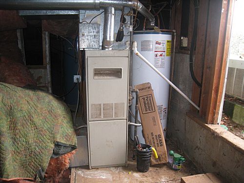

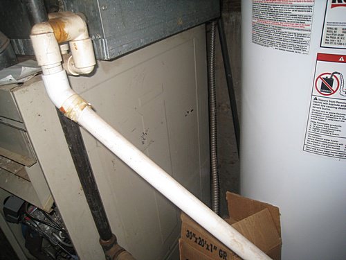

Chris Bernhardt Posted March 15, 2008 Report Share Posted March 15, 2008 I have been scanning furnaces looking for anomalies like these. This was the first time I found something interesting. The furnace is in a crawlspace and is an 1978 lennox model. Image Insert: 81.51 KB Image Insert: 72.96 KB View of right side furnace Image Insert: 31.07 KB IR view of right side of furnace Image Insert: 30.88 KB IR view of back of furnace. Chris, Oregon Link to comment Share on other sites More sharing options...
hausdok Posted March 15, 2008 Report Share Posted March 15, 2008 That furnace is at about 150% of its normally expected service life. Does it have a pilot light? If so, that may be where the hot gas from the pilot turns on it's way to the flue. Hot spots on the cabinet typically indicate a crack in the exchanger, but that's only 88 degrees. Is that with the furnace running? If so, I don't think it's being caused by a crack. Maybe there's something wedged in there. That's a less-than-ideal environment for a furnace to be operating at 1-1/2 times service life. I'd bet it's about time for replacement. ONE TEAM - ONE FIGHT!!! Mike Link to comment Share on other sites More sharing options...
Chris Bernhardt Posted March 15, 2008 Author Report Share Posted March 15, 2008 It was retro fitted with an automatic pilot. My bad I should have scanned it before I turned it on. I will do that from now on. I scanned it after the first couple of minutes but took the pics after about 10 minutes of operation. The contrast increased between the two times but I agree it usually is hotter where there is a cracked heat exchanger. I didn't take a physical measurement of the temperature nor did I try and calibrate the camera. I would't take the indicated temperature as real. Chris, Oregon Link to comment Share on other sites More sharing options...

ghentjr Posted March 15, 2008 Report Share Posted March 15, 2008 I think that Lenox had a flat steel back that was prone to cracking. It did not have the typical ported exchanger. What I would take away from the back photo is a failed exchanger. Link to comment Share on other sites More sharing options...
