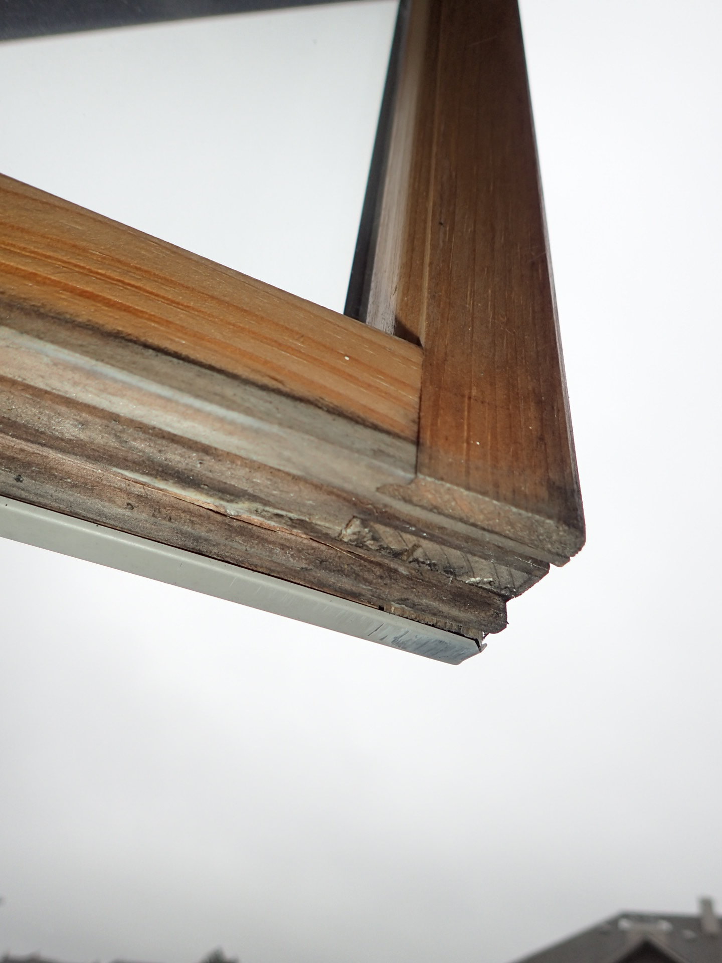

John Dirks Jr Posted April 27, 2018 Report Share Posted April 27, 2018 (edited) The older Anderson wood frame windows are the topic here. Not just the windows but also the framework surrounding the windows. Most of the time I see these windows they are in homes built in late 80's and throughout the 90's. They have a wooden frame and sill that is encased in vinyl. The corners of the wood sill are exposed and I assume a point of water intrusion. Sometimes there's significant rot of the sill and sometimes not, even mixed on the same house. Sometimes the sill is completely rotted and all that is left is the hollow vinyl cover. What allows the water intrusion that causes this rot? For those of you who have removed these windows with the rotted sills, what condition have you found the surrounding framing in? Edited April 27, 2018 by John Dirks Jr wordy Quote Link to comment Share on other sites More sharing options...
Les Posted April 27, 2018 Report Share Posted April 27, 2018 John, anecdotally we started writing the open sill ends and were corrected by the local distributor. We had advised simply caulking them. He, informally, told us that was designed to be open, but offered no real scientific reason. Mentioned it may be for ventilation or prevent the water that may have penetrated the horizontal sill becoming seal into wood. we still mention it. we have found, like you, many rotted and many nothing. interested to see what others post. Quote Link to comment Share on other sites More sharing options...
Mike Lamb Posted April 27, 2018 Report Share Posted April 27, 2018 I find that older wood windows from the 80s and earlier are doing just fine and I assume it's because of the chemicals used to treat the wood. The 1990s had horrible problems with rotting wood and not just Anderson but, Norco, ROW, Marvin, etc. I think the windows are clad with aluminum and not vinyl. Regardless, water gets behind the cladding and sits there and the poorly treated wood rots rapidly. I believe there was a class action suit against Marvin. I make a point to check all windows carefully especially at the lower corners of the sash. Blackening is the prelude to rot and I always point that out in the report. Here are some recent pictures of a 1990s condo. Quote Link to comment Share on other sites More sharing options...

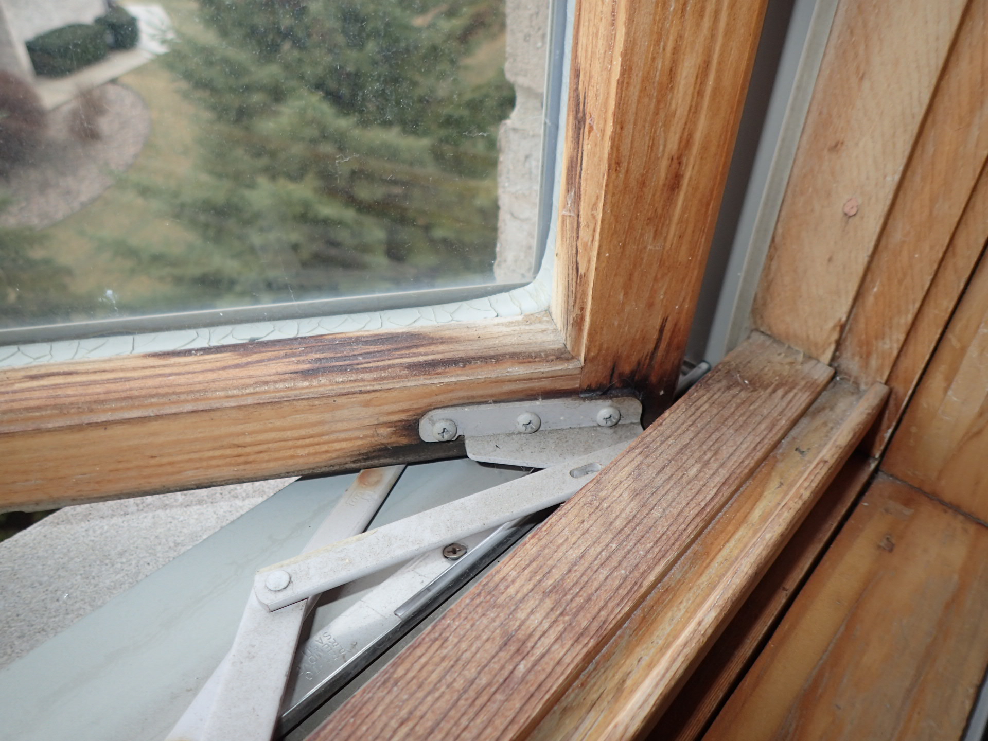

palmettoinspect Posted September 18, 2018 Report Share Posted September 18, 2018 I've experienced many time what you're referring to with these Anderson windows. It's not just the single/double hung windows, but also the casement windows. I always do the "push" test where I open the window and push on the sill to feel for rot. Also, as you open the windows you can usually see the hardware is loose from the rot. My theory with the casement windows is the water penetrates around the lower hardware and cracks that form in the vinyl cladding. The moisture and rot at the single and double hung windows is likely from the exposed corners. Most windows I see are exposed to an extreme beach climate so the damages are pretty bad. Quote Link to comment Share on other sites More sharing options...

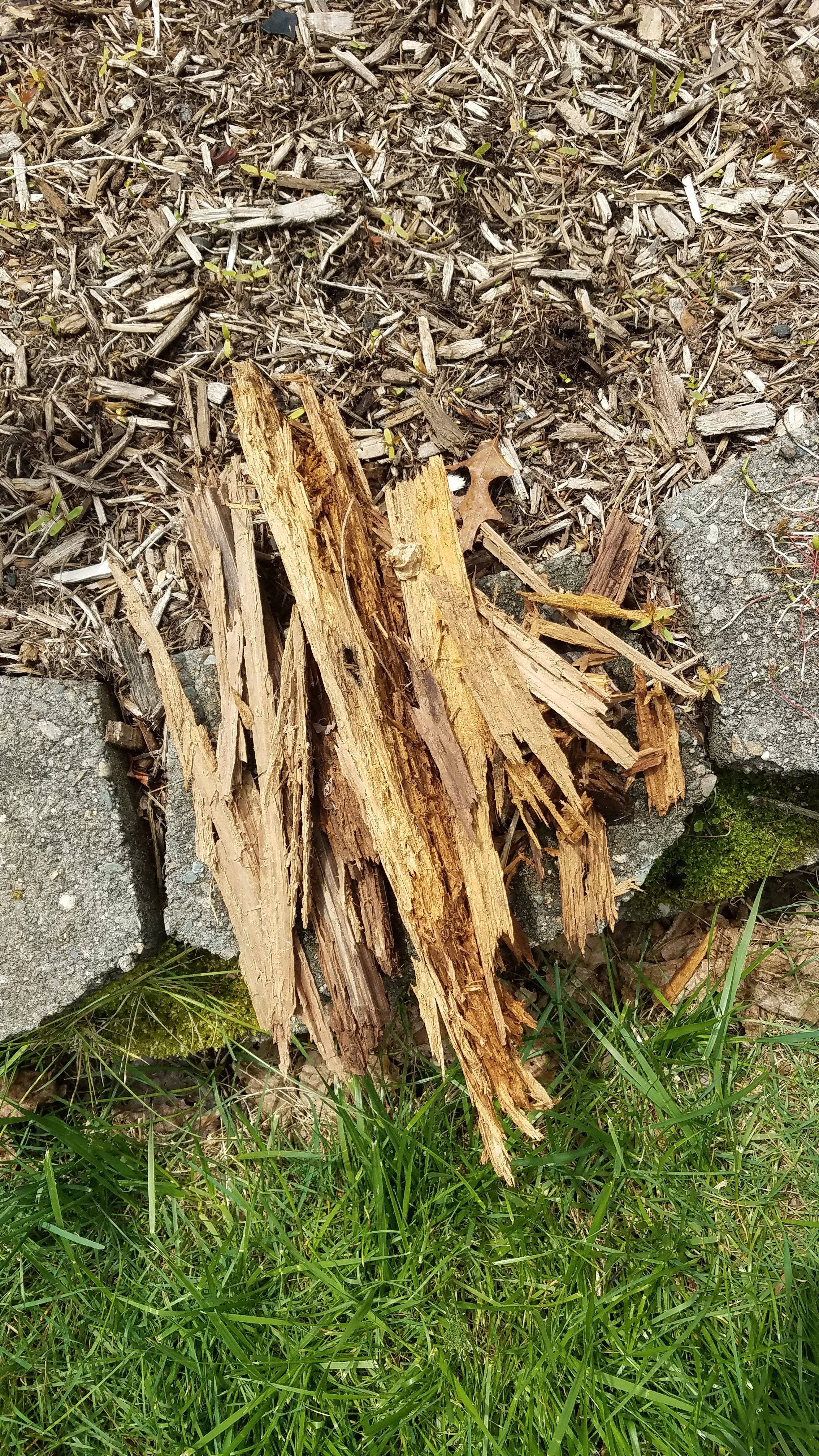

enfd240 Posted May 2, 2020 Report Share Posted May 2, 2020 (edited) First off thank you all for your insight. So today i started digging out the rotted wood from the end openings with a coat hanger with a little half loop bend... Was getting the wood out, but it was a tedious process... After 45 minutes i decided to go another route. I slit the vinyl along the bottom edge. There's a groove so the blade went right along it. Once slit open, my wife lifted the vinyl up from inside the window. I was able to then get my hand inside and using a screwdriver, removed all the wood in larger pieces. The entire wood sill was wet rotted, nothing left of it. Luckily the bottom of the jambs are in pretty good shape. Little rot that I'll hit with wood hardener. Next step. . I'm figuring that now that I have access to inside the vinyl, I'll rip a piece of pressure-treated wood to the right size and slide it in, then with epoxy fill in any gaps. Edit:. Added a picture of the largest pieces of the still... Edited May 3, 2020 by enfd240 Quote Link to comment Share on other sites More sharing options...

Brkstr Posted May 23, 2020 Report Share Posted May 23, 2020 Hello all, I have experienced same problem with my Andersen 200 narrowline double hung windows circa 1981. The bottom sash is vinyl clad with wood interior with the ends exposed wood. The wood is almost completely gone from rot. I only have two windows with this problem. They are on the south side of my house and are the most exposed to the weather. The rest of the windows in my house are under a significant overhang and protected from the weather so no problem with those yet. On one of the windows I removed the interior trim of the window covering the bottom sash this exposed the front side of vinyl clad sill. I drilled 8 holes using a 1/4 inch bit in the front of the sill. I sprayed window and door foam filler in all the holes. It filled the vinyl sill pretty effectively. Quite a bit flowed out the exterior corners so if you do this either cover the corners or have something catch the foam as it spills out. After the foam dried, I cutoff the exposed foam that expanded out the holes. Then I put the interior trim back on covering the holes. This seems to have worked. I’ve read on other forums that foam might prevent proper drainage of the window This is weird how Andersen might have designed a window that requires drainage around a piece of wood. I’m not sure if the foam will cause a drainage issue or not. I’m waiting for some heavy rain storms to try and inspect before I do my other window. Has anyone else tried this solution and have had problems with drainage or any other thoughts? Quote Link to comment Share on other sites More sharing options...
