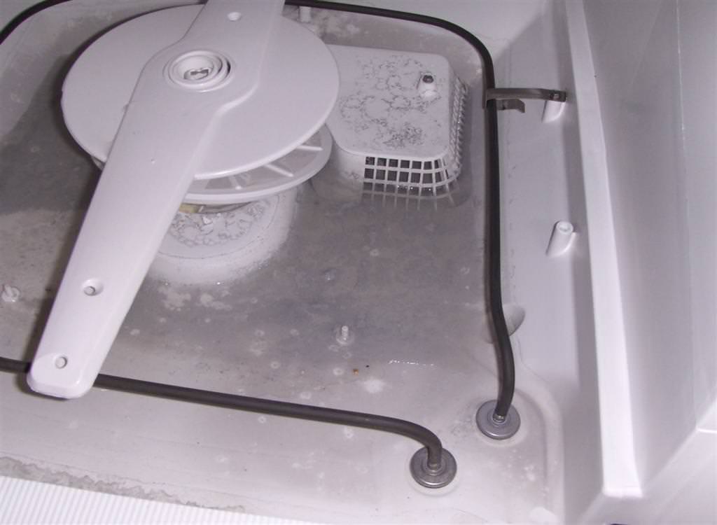

John Dirks Jr Posted April 13, 2008 Report Share Posted April 13, 2008 These bozos didn't use a clamp on the dishwasher drain line. It's so loose it will just blow off the first time the machine pumps water through it. Image Insert: 79.24 KB They didn't hang the loop high enough. Image Insert: 77.87 KB Last but not least, they washed their tools clean of joint compound in the kitchen sink and back fed the dishwasher. Image Insert: 68.3 KB Can you say Bubba? Link to comment Share on other sites More sharing options...
Bruce King Posted April 13, 2008 Report Share Posted April 13, 2008 Looks like a cheap dishwasher and needs the high loop. The more expensive ones have the high loop already built in. Link to comment Share on other sites More sharing options...
