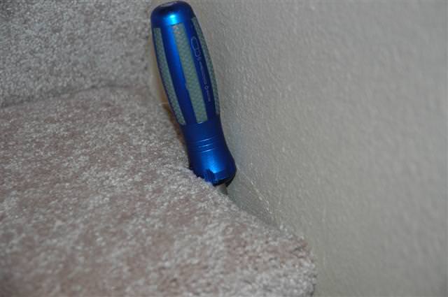

Robert Jones Posted July 8, 2008 Report Share Posted July 8, 2008 I had the opportunity to inspect a wonderful conversion today(used to be an apartment and was converted to a condo). One of the numerous items that were noted was, the risers leading to the second floor had gaps of up to 2" on either side of the treads. The carpet wasn't stapled to anything, I am guessing nothing was there to staple to;) Lack of stringer(s) issue? Anyone have any other idea? Thanks, Rob Image Insert: 43.33 KB Image Insert: 45.78 KB Quote Link to comment Share on other sites More sharing options...

randynavarro Posted July 8, 2008 Report Share Posted July 8, 2008 Typically, they'll hold the stringers off the wall a good 1" so they can drop the drywall down and behind the treads easier. Or, they leave the room for installing a wood (or plywood) skirt. I'm not sure there's a defect there. Quote Link to comment Share on other sites More sharing options...
Robert Jones Posted July 8, 2008 Author Report Share Posted July 8, 2008 I think my main issue is that toes and in this case parts of the foot could easily be caught in between the tread and wall, creating a safety issue. I realize that there is normally a small gap there but this seemed extreme. Quote Link to comment Share on other sites More sharing options...

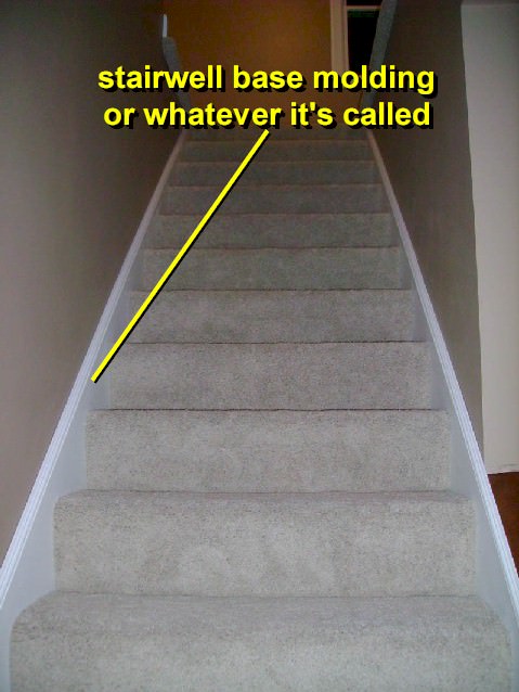

Richard Moore Posted July 8, 2008 Report Share Posted July 8, 2008 Originally posted by randynavarro Or, they leave the room for installing a wood (or plywood) skirt. Yeah. I'm not sure of the proper name, but it looks like someone got cheap and left off the moldings. Gonna have some nice scuff marks on the drywall after a few vacuumings. Image Insert: 76.78 KB Quote Link to comment Share on other sites More sharing options...
gtblum Posted July 8, 2008 Report Share Posted July 8, 2008 Rob, Given the number of accepted styles for stairs out there, I'm not sure I see an issue either. This looks like a set of utility stairs used during construction like Randy says. I've taken many of these out to build the finished staircase at the completion of the project. Maybe the budget only allowed for carpet. Quote Link to comment Share on other sites More sharing options...

hausdok Posted July 8, 2008 Report Share Posted July 8, 2008 I'd kind of like to see and take pictures of the guy or gal who walks so splay-footed that they'll get their toes over the ends of those treads into that narrow gap. That would be a strange sight. ONE TEAM - ONE FIGHT!!! Mike Quote Link to comment Share on other sites More sharing options...
AHI in AR Posted July 9, 2008 Report Share Posted July 9, 2008 Around here, the 1X finishing out the ends of the treads/risers is called a mop board. Admittedly, you'd have to be a special ed student to mop carpet, but I assume that the term predates the relatively modern practice of completely carpeted stairs. And, yes, it is standard practice to leave a gap at the ends of the treads to allow for slipping the mop board in without notching it for the treads and risers. The stringer is the structural member UNDER the treads which holds them up. You won't normally see it from any finished living space, and you sure won't see it from the top side. While sloppy, I agree that it's not a real hazard. It would seem to be a really odd walking pattern that could land your toes there. Quote Link to comment Share on other sites More sharing options...

hausdok Posted July 9, 2008 Report Share Posted July 9, 2008 Hi, Pardon my saying so, but I think this is a non-issue. I'd never thought about it really, so I just walked out into the hallway and checked the stairs leading to the second floor. Guess what; they're done the same way and I'd never noticed it. I don't even want to guess at how many stairways I've done where the situation is probably identical. For the past couple of years dozens of my wife's friends have had a long procession of toddlers and small children, as well as elderly folks, in and out of this house walking up and down those stairs. Not a single one of them has ever tripped or fallen due to that gap. Probably because when you put your foot over the gap, it's not noticeable through one's shoe. Besides, if a kid is small enough to stick a foot or arm through that gap the kid is probably too small to push his or her hand past the carpet and is way too small to be on stairs unattended anyway. There are plenty of other more important things to be concerned about with stairs but, from a practical standpoint, I don't see this as one of them. ONE TEAM - ONE FIGHT!!! Mike Quote Link to comment Share on other sites More sharing options...
Tom Raymond Posted July 9, 2008 Report Share Posted July 9, 2008 Mike, While I agree that the stairs as is are not a safety concern, the fact that the builder left out such a simple detail would have me looking at what else he cut corners on. Tom Pretty cheap to leave out a couple of 1x10's[:-thumbd] Quote Link to comment Share on other sites More sharing options...
