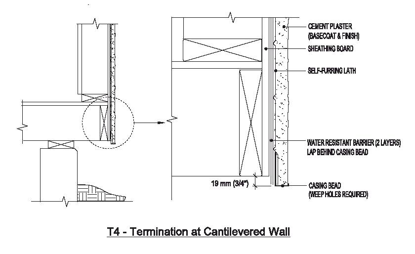

voight Posted June 15, 2004 Report Share Posted June 15, 2004 Are weep screeds for stucco only required/suggested at the bottom of the stucco next to foundation walls. How about at the bottom of stucco at cantilevered walls? Dave Voight Honest Home Inspections Quote Link to comment Share on other sites More sharing options...
hausdok Posted June 16, 2004 Report Share Posted June 16, 2004 Hi Dave, Cantilivered walls are supposed to have a casing bead with weep holes. The wall sheathing should extend a minimum of 3/4 inch below the framing, your water resistant barrier (2 layers grade D paper)extends the full length of the sheathing and is behind your casing bead, sefl-furring lath is applied and overlaps the casing bead and then stucco is applied. ONE TEAM - ONE FIGHT!!! Mike Quote Link to comment Share on other sites More sharing options...

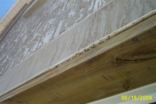

Danny Pritchard Posted June 16, 2004 Report Share Posted June 16, 2004 Speaking of weep screeds.I don't remember seeing this application before and today I saw it twice.The picture is a garage door header.You can see part of the weep screed installed right on top of the 2x.This is a new home the other house was 4 years old both done the same way.Typically the stucco would wrap the opening or there would be vinyl or some other type nail on siding in this area. Download Attachment: Blocked weep screed0002.jpg 70.08 KB Quote Link to comment Share on other sites More sharing options...
hausdok Posted June 16, 2004 Report Share Posted June 16, 2004 Hi Danny, It's close to right. It needs a head flashing, a slight taper on top of that trimmer and a little bit of clearance (about 3/8 inch) from the bottom of the casing bead to the head flashing. OT - OF!!! M. Quote Link to comment Share on other sites More sharing options...

Danny Pritchard Posted June 16, 2004 Report Share Posted June 16, 2004 Mike said "It's close to right. It needs a head flashing, a slight taper on top of that trimmer and a little bit of clearance (about 3/8 inch) from the bottom of the casing bead to the head flashing." We are thinking on the same page.I mentioned the lack of Z flashing and the clearance.Also mentioned the way stucco is stopped on walls at roofline as a good example of how it should have been done. Quote Link to comment Share on other sites More sharing options...

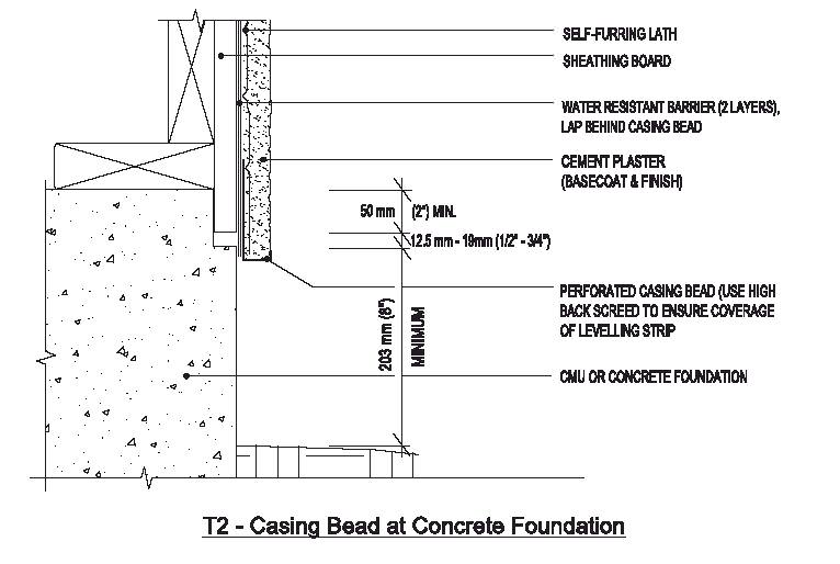

RobC Posted June 17, 2004 Report Share Posted June 17, 2004 This is an illustration I use to explain proper termination detailing of stucco at cantilevers. Download Attachment: TerminationCantileveredWall.JPG 46.03 KB Here is a foundation/wall illustration. Hope this helps. Download Attachment: CasingBead_ConcreteFdn.JPG 53.31 KB Quote Link to comment Share on other sites More sharing options...

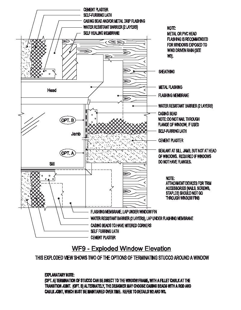

RobC Posted June 17, 2004 Report Share Posted June 17, 2004 OK! I couldn't resist This is for the forensic inspectors out there. Download Attachment: WidowHeadFlashingAssem.JPG 112.89 KB Download Attachment: WindowExplodedElev.JPG 150.49 KB Enjoy Quote Link to comment Share on other sites More sharing options...
hausdok Posted June 17, 2004 Report Share Posted June 17, 2004 Hi Rob, I've got the same manual, but it must be earlier or later. Your T4 is my T5 and your T2 is my T7. OT - OF!!! M. Quote Link to comment Share on other sites More sharing options...
