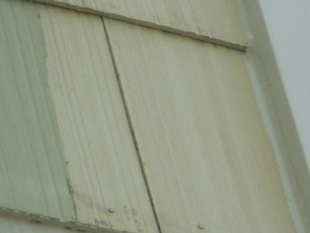

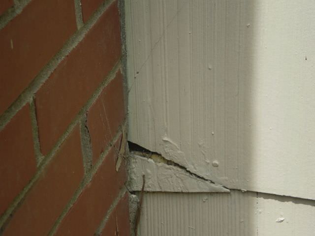

tnpappas Posted July 23, 2009 Report Share Posted July 23, 2009 I am pretty sure this is asbestos siding. There are a few areas with minor damage. This siding is on the right and left side of the house, and vinyl siding on the front and rear. With only minimal damage would you write it up to have damaged sections sealed or have it all replaced and removed? What wording do you all use in your reports when reporting on asbestos? Click to Enlarge 29.82 KB Click to Enlarge 23.48 KB Click to Enlarge 22.1 KB Click to Enlarge 32.89 KB Quote Link to comment Share on other sites More sharing options...
waynesoper Posted July 23, 2009 Report Share Posted July 23, 2009 Asbestos siding is installed on thsi home. Damage was noted in many areas and should be repaired by a licensed contractor. Click on link for more information on Asbestos http://www.epa.gov/asbestos/pubs/ashome.html keep it simple! Quote Link to comment Share on other sites More sharing options...
Scottpat Posted July 23, 2009 Report Share Posted July 23, 2009 I think I might say this: The cement asbestos shingles on the home are damaged in several locations (list locations if you want). This product is no longer made but similar looking replacement shingles made from non asbestos containing materials can be found. Have a qualified contractor make the needed repairs. That is about all I would say. Quote Link to comment Share on other sites More sharing options...

gtblum Posted July 24, 2009 Report Share Posted July 24, 2009 Originally posted by tnpappas I am pretty sure this is asbestos siding. There are a few areas with minor damage. This siding is on the right and left side of the house, and vinyl siding on the front and rear. With only minimal damage would you write it up to have damaged sections sealed or have it all replaced and removed? What wording do you all use in your reports when reporting on asbestos? The siding is damaged on the and or at the area of the home / house. The siding shingles look like a type of shingle that has been known to contain asbestos. Ect. Don't commit if you're not 100% sure. Quote Link to comment Share on other sites More sharing options...
charlieb Posted July 24, 2009 Report Share Posted July 24, 2009 What looks like asbestos shingles have been used as the siding material on this home. Lab testing of the material is the only way to verify their content. Repairs to asbestos shingle siding should be approached with care, as any breakage of the shingles releases asbestos fibers, which are designated by the EPA as causing cancer. Shingles should not be scraped, sanded or drilled for fear of releasing fibers. Any shingles removed should be disposed in a proper manner, consistent with current EPA regulations. Some damage was found in the asbestos siding. Due to the safety issues with asbestos it is no longer available. There are other products which come close in appearance to some designs of this siding - but not all designs. This may limit your ability to replace this siding. Quote Link to comment Share on other sites More sharing options...
