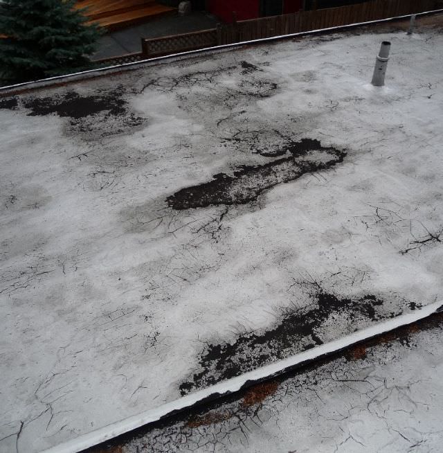

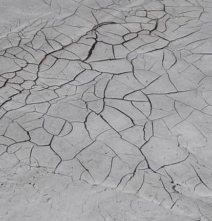

Richard Moore Posted August 8, 2009 Report Share Posted August 8, 2009 I had a 60 year old home today with a mostly flat roof (MLS described as torch-down). It had the deepest and worst alligatoring I have yet seen, all over the roof. Also had ponding stains in various areas. No question it needs repair/replacement, but I have a question. The reflective coating looked to be maybe 5 years or less, although there were a couple of patched areas on top of that. As you may be able to tell from the photo, the cracks have appeared since the coating was applied. I thought these normally happened over time, but could our recent record heat wave have caused this deep cracking just in the last couple of weeks? The reason I ask is that we haven't had any rain for almost a month now. There weren't any ceiling stains (no attic spaces) but I have to wonder if this whole roof isn't going to leak like a sieve if it doesn't get fixed before the next rain. (Rain showers are actually forcast to start tomorrow - we need it!) Click to Enlarge 49.23 KB Quote Link to comment Share on other sites More sharing options...
Jim Katen Posted August 8, 2009 Report Share Posted August 8, 2009 Unless the picture is very misleading, that looks like typical alligator cracking on the flood coat on top of a traditional built up roof. Admittedly, it looks like it was an overly generous flood coat. I used to see that all the time and the cracks rarely extended through the top layer of felt. - Jim Katen, Oregon Quote Link to comment Share on other sites More sharing options...
kurt Posted August 8, 2009 Report Share Posted August 8, 2009 Alligatoring does not mean anything other than the installer flooded too much asphalt onto the roof. It doesn't hurt anything, and it doesn't mean the roof is about to fail, or failed. It's just too much asphalt. Quote Link to comment Share on other sites More sharing options...

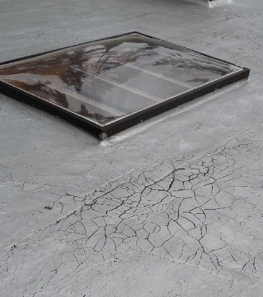

Richard Moore Posted August 8, 2009 Author Report Share Posted August 8, 2009 Here's a wider angle of the same area. The skylight is about 3'x5'. The alligator segments were larger and the cracks deeper (1/2"+ in places) than I've ever seen before. Click to Enlarge 79.58 KB So, if the problem is too much asphalt, what's the solution...more? The clients already have a couple of roofers lined up for evaluation and estimates. Quote Link to comment Share on other sites More sharing options...
Jim Katen Posted August 8, 2009 Report Share Posted August 8, 2009 Here's a wider angle of the same area. The skylight is about 3'x5'. The alligator segments were larger and the cracks deeper (1/2"+ in places) than I've ever seen before. So, if the problem is too much asphalt, what's the solution...more? The clients already have a couple of roofers lined up for evaluation and estimates. That's definitely a built up roof. If the flood coat was 1/2" deep, then the cracks will be 1/2" deep -- that's just what thick flood coats do. Look carefully into the cracks to see if the felt is damaged. I use a thin-bladed knife to gently feel for the severed edges of felt. 99% of the time, the crack doesn't extend below the felt. The internal faces of the crack are just a smooth fracture. If that's the case, there isn't any need for a solution. - Jim Katen, Oregon Quote Link to comment Share on other sites More sharing options...
Richard Moore Posted August 8, 2009 Author Report Share Posted August 8, 2009 Thanks Jim, but... Look carefully into the cracks to see if the felt is damaged. I use a thin-bladed knife to gently feel for the severed edges of felt. 99% of the time, the crack doesn't extend below the felt. That sounds good, but this was about 1500sf of roof with these areas everywhere. I would be up there for hours probing the thousands of cracks. On a flat roof, especially one with ponding issues in some areas, that 1% could cause major damage. The internal faces of the crack are just a smooth fracture. If that's the case, there isn't any need for a solution. I can see that the felt may be, even probably is, still intact but, with all due respect, I have a hard time with no solution needed. If I could see felt in the cracks then isn't that felt now subject to damage that the flood coat was supposed to prevent? Quote Link to comment Share on other sites More sharing options...
Jim Katen Posted August 8, 2009 Report Share Posted August 8, 2009 Thanks Jim, but... Look carefully into the cracks to see if the felt is damaged. I use a thin-bladed knife to gently feel for the severed edges of felt. 99% of the time, the crack doesn't extend below the felt. That sounds good, but this was about 1500sf of roof with these areas everywhere. I would be up there for hours probing the thousands of cracks. On a flat roof, especially one with ponding issues in some areas, that 1% could cause major damage. I'm not suggesting that you probe every crack. Just a few will tell you what you need to know. You'll either find torn felt down there or you won't. There won't be a lot of variation. By the time these cracks lead to leaks, they'll look different than they do in your picture; they'll be peeling up along with the top layer of felt below them. The internal faces of the crack are just a smooth fracture. If that's the case, there isn't any need for a solution. I can see that the felt may be, even probably is, still intact but, with all due respect, I have a hard time with no solution needed. If I could see felt in the cracks then isn't that felt now subject to damage that the flood coat was supposed to prevent? It depends on a lot of factors. The roof in your picture might be toast, but not because of the alligatoring. The thick flood coat wasn't put there to protect the felt, it was put there by lazy roofers who, when they were done with the roof, had a bunch of leftover asphalt in their applicator. To get rid of it, they just spread it around on the roof. After all, if a little floodcoat is good, a lot must be better, right? Don't get me wrong. Alligatoring isn't a good thing and it isn't inevitable. It's usually the result of a less than perfect installation. Eventually, it might even cause the roof to leak, but by that time it won't look the way it does in your pictures. It will have started to peel. That is, each little "island" formed by the cracks will start to lift at its edges forming a dish shape and tearing away the top layer of felt below it. When that happens, water can enter between the plys and cause leaks. At this point, the best thing for this roof is to have a reflective coating -- and it already does. I suppose that you could lightly pressure wash it and apply more reflective coating but I'm not sure it would help much. None of that really matters at this point because the two roofers who will come look at it will recommend replacement anyway. - Jim Katen, Oregon Quote Link to comment Share on other sites More sharing options...
kurt Posted August 8, 2009 Report Share Posted August 8, 2009 My comments are based on having looked at approx. 3500 "hot tar" flat roofs. I still see tar pot installations fromt time to time, but they're getting scarce. Alligatoring isn't good, but it doesn't do anything bad. I see them where they are full of ice, and have been for a dozen winters. Nothing bad happens. Ever. Probing the cracks might tell you something, but probably not. Roofer consultants all zero in on it like it's going to make the roof explode, but nothing ever happens. Years ago, I met a guy that was the lead foreman on replacing the roof on McCormick Place (at the time, the largest roof in the world), and he explained how all this stuff works in real time. It just means someone flooded too much tar on the roof. Like Jim said, the roofers are going to recommend replacement anyway. Quote Link to comment Share on other sites More sharing options...
Richard Moore Posted August 8, 2009 Author Report Share Posted August 8, 2009 Thanks guys. I really appreciate your input. So...probably not as bad as it looks, but I still see no way I could "bless" the roof for my clients and "punting" to the roofers seems my only choice. Quote Link to comment Share on other sites More sharing options...
kurt Posted August 8, 2009 Report Share Posted August 8, 2009 Your observation that there are some areas of ponding is the significant point, not the alligatoring. Ponding on flat roofs is death. Period. That alone would allow you to condemn the sucker. Sure, I know that there are still a few coal tar pitch roofs intended to pond water (the water helped cool the building in hot weather), but in our world, ponding means failure in almost all cases. Quote Link to comment Share on other sites More sharing options...
