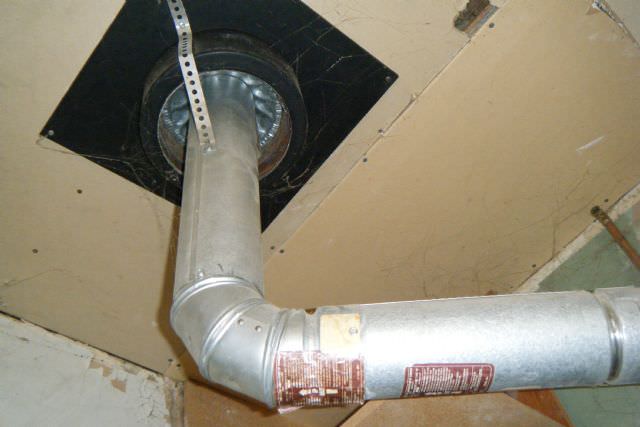

Brandon Whitmore Posted November 8, 2009 Report Share Posted November 8, 2009 Click to Enlarge 65.32 KB The stovepipe meets clearances to combustible materials, or does it? Link to comment Share on other sites More sharing options...
Jim Katen Posted November 8, 2009 Report Share Posted November 8, 2009 The stovepipe meets clearances to combustible materials, or does it? That vent only requires 2" clearance to combustibles. - Jim Katen, Oregon Link to comment Share on other sites More sharing options...
Jeff Remas Posted November 8, 2009 Report Share Posted November 8, 2009 I don't see any clearance issues. Why a code cite? Does the manufacturer have any particular requirements? Link to comment Share on other sites More sharing options...
hausdok Posted November 8, 2009 Report Share Posted November 8, 2009 I think that Brandon might be referring to the distance from the vent to the conductors at the masthead. From the rust on that masthead, it sure looks like things get pretty hot up there. I can't find any reference to it in my guide from Puget Sound Energy. Was the insulation on those cables or the insulator at the masthead being affected, Brandon? ONE TEAM - ONE FIGHT!!! Mike Link to comment Share on other sites More sharing options...
Jim Katen Posted November 8, 2009 Report Share Posted November 8, 2009 I think that Brandon might be referring to the distance from the vent to the conductors at the masthead. From the rust on that masthead, it sure looks like things get pretty hot up there. I can't find any reference to it in my guide from Puget Sound Energy. Was the insulation on those cables or the insulator at the masthead being affected, Brandon? I can't imagine that the rust is related to heat from the vent. It *might* be related to smoke from the vent. In that case, I'd just scrape, prime, & paint the mast. - Jim in Oregon Link to comment Share on other sites More sharing options...
Richard Moore Posted November 8, 2009 Report Share Posted November 8, 2009 Or maybe use the shorter, newer mast. What's with that? Non-completed service upgrade? Link to comment Share on other sites More sharing options...
Brandon Whitmore Posted November 8, 2009 Author Report Share Posted November 8, 2009 I think that Brandon might be referring to the distance from the vent to the conductors at the masthead. That's it. I didn't want to go too far into this one with my original post. I was curious what you all would say. The 3-2-10 rule has been met. I have a slight concern with heat coming out of the chimney during normal operation. My BIG concern would be a flue fire at the top of the chimney. I doubt that the wire would get hot enough, long enough to fail, but the insulation inside and just outside of the mast could fail in my opinion. There was no longer a woodstove installed. The owners (rental) installed a new gas water heater beneath this area. They ran the B vent from the water heater up to the ceiling where they just connected it into the existing chimney pipe. Click to Enlarge 35.92 KB Was the insulation on those cables or the insulator at the masthead being affected, Brandon? Maybe, the insulation was cracked and deteriorated, but it just looked like old insulation to me. If there was still a woodstove attached, I would have written it up whether or not I had a reference. It *might* be related to smoke from the vent. In that case, I'd just scrape, prime, & paint the mast. If I was a betting man, I'd bet the smoke had something to do with it. This house was built in the '50s. I can't recall ever seeing a house this newish that had a mast this heavily rusted. Or maybe use the shorter, newer mast. What's with that? Non-completed service upgrade? I thought that was weird as well. It looks like they just stuck that second mast in there to take the weight off of the tall skinny existing one. When I drove up, I expected to see the original skinny guy to be bent, but this was not the case. The original fuse box is still in use on this one, with a Bulldog Pushmatic installed next to it for a few add on circuits. Link to comment Share on other sites More sharing options...

Billy_Bob Posted April 22, 2010 Report Share Posted April 22, 2010 When I installed a woodstove in my house, the building inspector went by the woodstove and chimney manufacturer's specifications and installation instructions. So *that* was the code. And clearances change by type and model, so I guess that is the best thing to go by. Here is a big manufacturer of chimneys... (Tons of documentation) http://www.selkirkcorp.com Then the electric company has "Electric Service Requirements" which would cover clearances. Here is that for Pacific Power (as an example)... http://www.pacificpower.net/con/esr.html Link to comment Share on other sites More sharing options...
