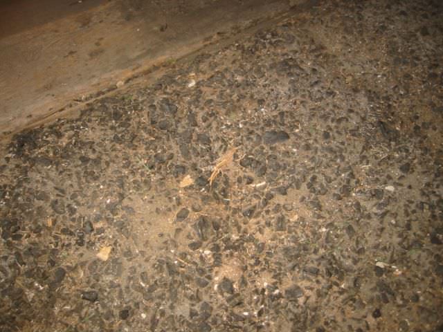

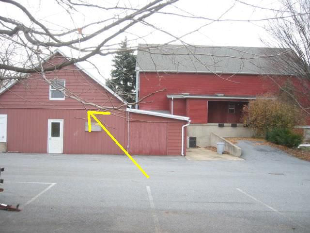

Inspectorjoe Posted November 26, 2009 Report Share Posted November 26, 2009 Here's my bizarre find of the week. A few days ago, I inspected a vacant retail property that evolved from 19th century farm buildings. The second floor of a post and beam building was floored with about an inch of blacktop. It looked just like you'd find in a parking lot, but it wasn't smooth - obviously they couldn't run a 4 ton roller over it. The building seemed to handle the weight well. There was no obvious sagging, but the areas below were finished and minor sagging wouldn't be too noticeable. It seemed to stiffen the floor greatly. Walking across it felt like walking on a slab. I'm not concerned about it, and the only mention of it in the report will be a description (still working on the report Thanksgiving morning). I'm just curious if anyone else has seen anything like this, and/or might know why it was done. Thanks, Happy Thanksgiving! Click to Enlarge 51.96 KB Click to Enlarge 57.08 KB Click to Enlarge 73.93 KB Quote Link to comment Share on other sites More sharing options...
kurt Posted November 26, 2009 Report Share Posted November 26, 2009 I've seen this in a couple loft buildings on the west side. I think it was done for a couple (completely misconceived) reasons. 1) "Smooth" flooring instead of rough planks; one can push ware carts over blacktop easily, not so over rough planks. 2) Quasi-idiotic "compliance" with fire codes, but that's just a guess. I think it's pretty much #1. Quote Link to comment Share on other sites More sharing options...
Tom Raymond Posted November 29, 2009 Report Share Posted November 29, 2009 If they were rolling carts around up there the "hard" floor may have been to control noise. I have been in very old working factories with wood floors, and I can tell you it's very scary when a forklift drives by overhead. Tom Quote Link to comment Share on other sites More sharing options...
Bill Kibbel Posted November 29, 2009 Report Share Posted November 29, 2009 I've inspected quite a few poultry barns that had blacktop over wood floors. None were on an upper level though. Quote Link to comment Share on other sites More sharing options...
Bain Posted November 29, 2009 Report Share Posted November 29, 2009 How'd they get the asphalt up to the second floor? Using wheelbarrows on the narrow staircase in the second photo? Imagine what an enjoyable chore that would have been. Quote Link to comment Share on other sites More sharing options...
caryseidner Posted December 2, 2009 Report Share Posted December 2, 2009 How'd they get the asphalt up to the second floor? Using wheelbarrows on the narrow staircase in the second photo? Imagine what an enjoyable chore that would have been. C'mon Bain! Most roofs are more difficult to access then the 2nd floor of a barn and they put hot asphalt on them all the time. Kettle on the ground and a hot pipe through the window, would be my guess. Quote Link to comment Share on other sites More sharing options...
Bain Posted December 2, 2009 Report Share Posted December 2, 2009 How'd they get the asphalt up to the second floor? Using wheelbarrows on the narrow staircase in the second photo? Imagine what an enjoyable chore that would have been. C'mon Bain! Most roofs are more difficult to access then the 2nd floor of a barn and they put hot asphalt on them all the time. Kettle on the ground and a hot pipe through the window, would be my guess. You must realize that I'm in Kentucky, where things are seldom performed the normal or natural way, especially when it comes to something like a barn. My synapses have been trained to expect the wacky and weird. Quote Link to comment Share on other sites More sharing options...
Brandon Whitmore Posted December 2, 2009 Report Share Posted December 2, 2009 You must realize that I'm in Kentucky, where things are seldom performed the normal or natural way, especially when it comes to something like a barn. My synapses have been trained to expect the wacky and weird. In that case, they may use a tractor or excavator for the scoop and dump method. Or better yet, maybe they just build the floor on the ground, lay the asphalt, and then lift the whole shebang into place. Sorry, I have a little free time on my hands this morning. Quote Link to comment Share on other sites More sharing options...
