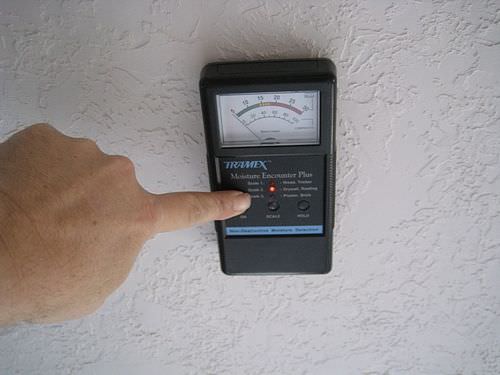

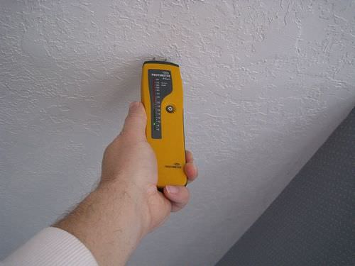

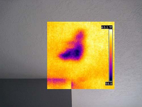

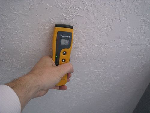

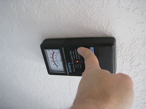

Chris Bernhardt Posted January 2, 2010 Report Share Posted January 2, 2010 Performance comparison between a surveymaster (actually an Aquant and protimeter) and a Tramex ME+ on wetness in a ceiling from a drain leak. Click to Enlarge 24.49 KB Click to Enlarge 27.62 KB Click to Enlarge 27.55 KB Click to Enlarge 25.33 KB Readings a foot away Click to Enlarge 28.2 KB Click to Enlarge 27.79 KB The Tramex ME+ is more sensitive than the SM. Using the SM only, could make confirming wetness in a ceiling more difficult. Chris, Oregon Quote Link to comment Share on other sites More sharing options...
kurt Posted January 2, 2010 Report Share Posted January 2, 2010 That's disturbing. Am I misreading the pics? It looks like the pin mode was not finding anything with the Aquant.....(?).... Quote Link to comment Share on other sites More sharing options...
Phillip Posted January 2, 2010 Report Share Posted January 2, 2010 If I remember right the Tramex ME+ does a deeper scan (2") than the SM (1/2"). Could it be that the leak had not made it down to the SM range? Chris, How did you find the leak in the first place? Quote Link to comment Share on other sites More sharing options...
Scottpat Posted January 2, 2010 Report Share Posted January 2, 2010 That's disturbing. Am I misreading the pics? It looks like the pin mode was not finding anything with the Aquant.....(?).... That would not be uncommon. In the pin mode the meters just detect the moisture at the location of the pins. So if the drywall has not become wet you end up with a good reading. The scan modes detect the moisture even before the drywall shows or becomes wet. The Tramex detects moisture in the wall cavity, I have had a Tramex detect up to 3" in depth! Quote Link to comment Share on other sites More sharing options...
Chris Bernhardt Posted January 2, 2010 Author Report Share Posted January 2, 2010 The home had been vacant for a year, so the leaking occurred when I ran the sink upstairs in the master bedroom. I had already scanned the ceilings on the first floor with my IR cam before running the plumbing upstairs, so I could make comparisons, which I do as a matter of practice. The point is that wetness that's just on the back of the ceiling drywall is not going to be readily confirmed by the SM. It doesn't mean the SM is useless, far from it. I use the SM & the Tramex ME+ both all of the time, even the protimeter to characterize moisture anomalies. I even use the super sensitive Tramex wet wall detector on occasion to help flush out or characterize anomalies. What I want to point out is that when you get your infrared camera, you might want to consider adding to your arsenal of moisture meters. Chris, Oregon Quote Link to comment Share on other sites More sharing options...

Eric Russell Posted March 1, 2010 Report Share Posted March 1, 2010 First of all, the GE Aquant is a non-destructive meter, meaning there are NO PINS. I don't even see a Surveymaster in the pics. How can your test be accurate about a Surveymaster when there's not even one being tested? I'm sure they all have their limitations, but if you're gonna compare a Tramex to a SM, then at least have a SM in the mix. Not angry or sarcastic...just wondering. Quote Link to comment Share on other sites More sharing options...
Scottpat Posted March 2, 2010 Report Share Posted March 2, 2010 First of all, the GE Aquant is a non-destructive meter, meaning there are NO PINS. I don't even see a Surveymaster in the pics. How can your test be accurate about a Surveymaster when there's not even one being tested? I'm sure they all have their limitations, but if you're gonna compare a Tramex to a SM, then at least have a SM in the mix. Not angry or sarcastic...just wondering. Good point, but the SM does only read about a 1/2" in depth and the ME goes down to around 2 1/2" in depth. Quote Link to comment Share on other sites More sharing options...
Chris Bernhardt Posted March 3, 2010 Author Report Share Posted March 3, 2010 First of all, the GE Aquant is a non-destructive meter, meaning there are NO PINS. I don't even see a Surveymaster in the pics. How can your test be accurate about a Surveymaster when there's not even one being tested? I'm sure they all have their limitations, but if you're gonna compare a Tramex to a SM, then at least have a SM in the mix. Not angry or sarcastic...just wondering. The SM is the Aquant and the Protimeter combined in the same package. I prefer the Aquant over the SM because it's form factor (no pins extending its length) can get into some tighter spaces. Chris, Oregon Quote Link to comment Share on other sites More sharing options...
