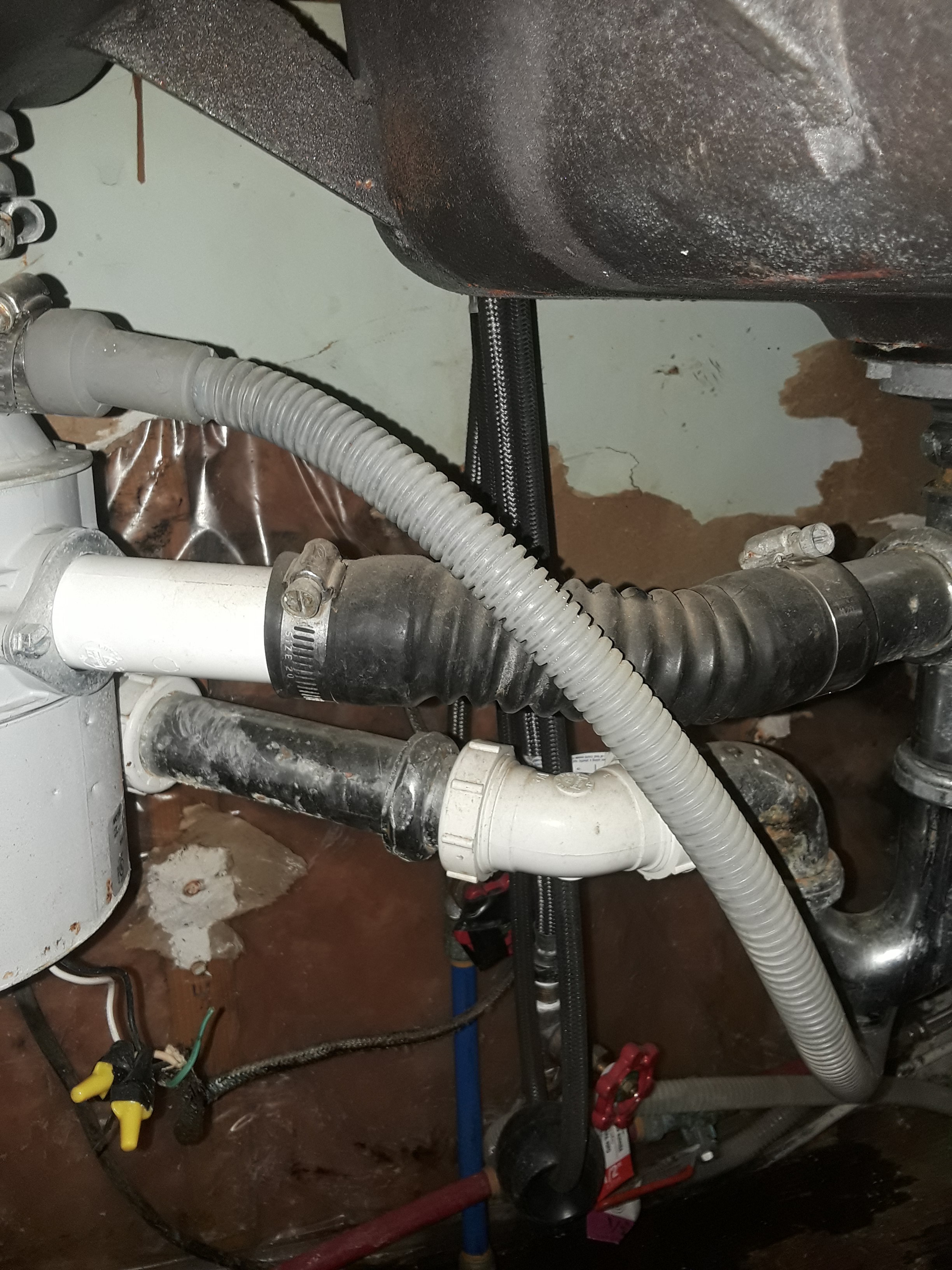

  4. After all the years of calling those flexible pvc drain lines under sinks radiator hoses,I came across this yoday.
  5. That' impressive butchering there.
  6. Yes they do,but the ones without the metal shielding under the band's are not no-hub couplings.
  7. Those are not no-hub couplings,They'e fernco. These are no hub couplings.
  8. A no hub transition fitting would be legal around omaha,a fernco is not though. It would have to be used underground,past the footing in omaha.

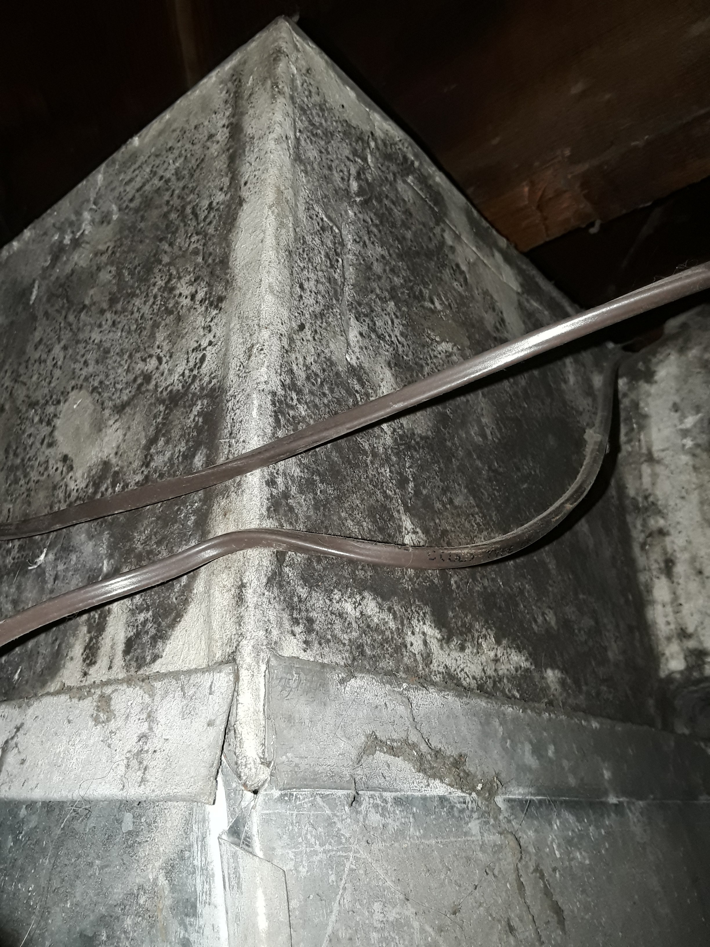

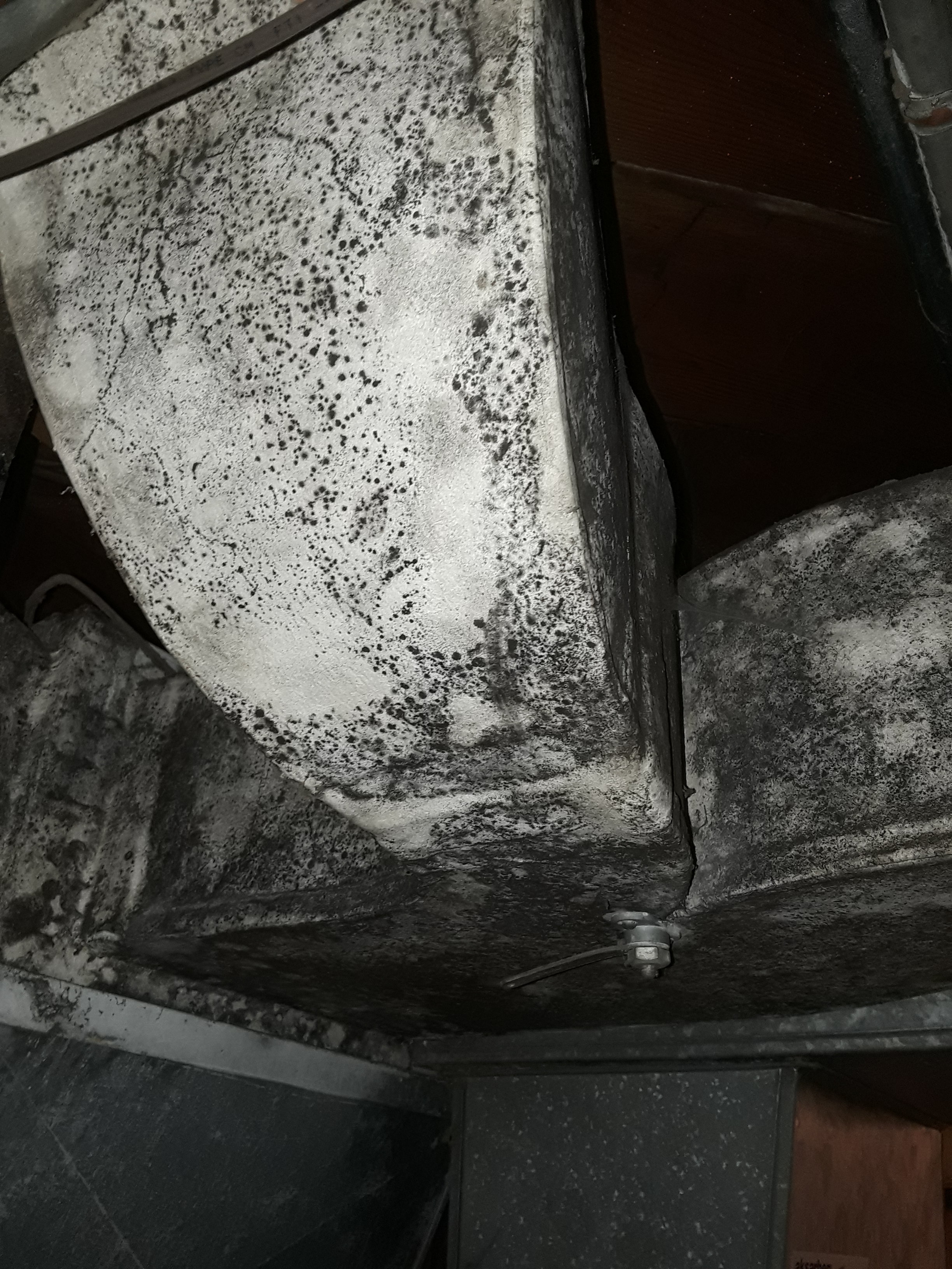

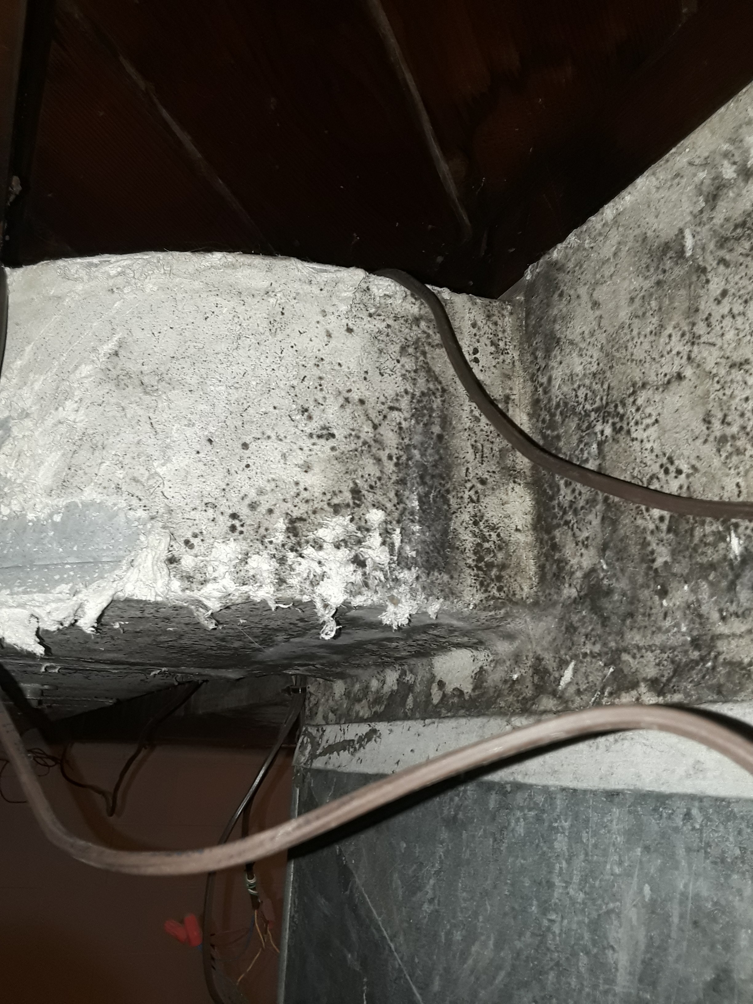

  11. Maybe I should have that mold guy tell me what he thinks about this basement the gas co tagged for gas leaks the other day.
