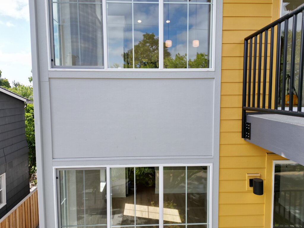

  5. When inspecting Hardie panel siding on new builds, I see it spanning floor systems about half of the time. Maybe more. Hardie's installation details require a horizontal seam in the siding at each floor system. I call it out when I see it done incorrectly, and the builders always respond as expected. "I've been doing it this way for years and I've never had a problem!" I'm curious. Have any of you even seen damage to Hardie panels because of the missing horizontal seam at a floor system?

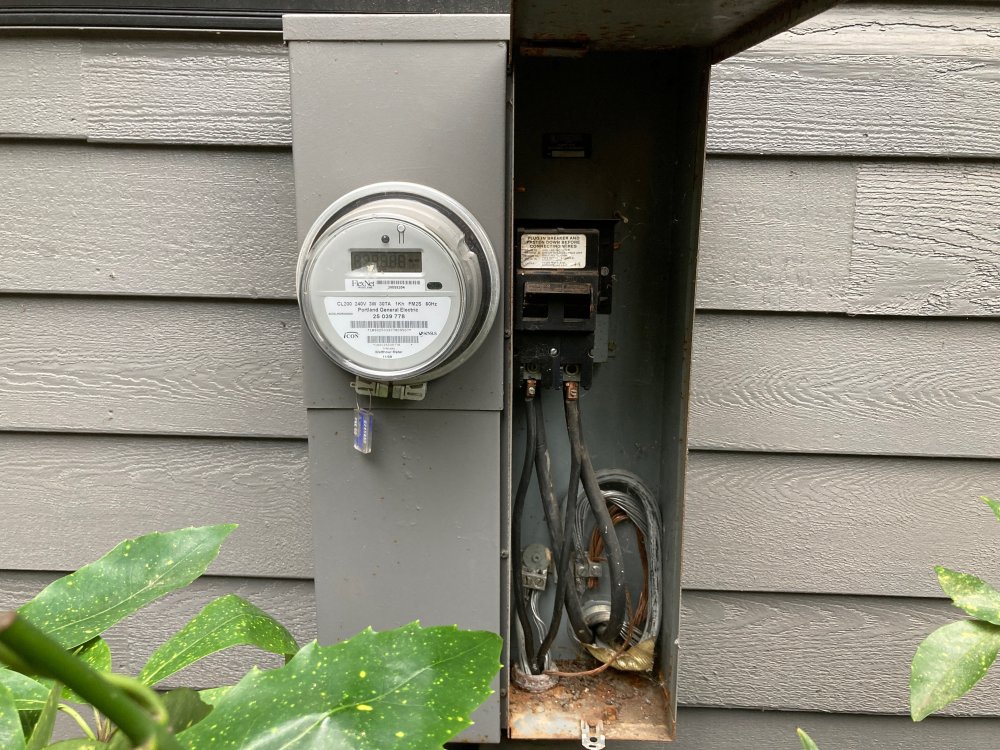

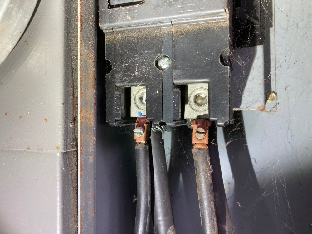

  11. Wondering if the connector would prevent the lug from securing the 4/0 aluminum conductors properly.
  12. Would this be considered a double tap? I don't think I've ever seen this done.

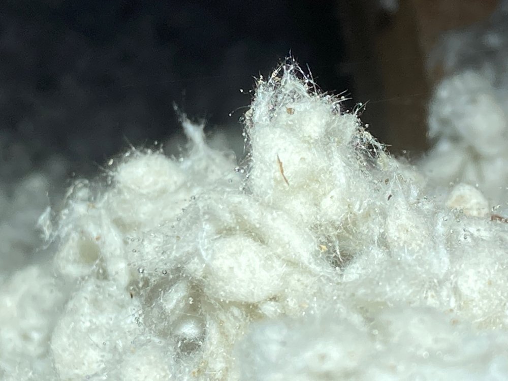

  15. I like the idea of the humidistat. That would be helpful in conveying to buyers and agents that the issue is not a roof leak but ambient moisture.

  17. Appreciate the response. Warm moist air rising and condensing was the only explanation I could think of considering the attic was well ventilated and the bath, laundry and kitchen were exhausting properly. My only confusion was that I don't see this very often. Most homes I inspect are not air sealed, especially older ones. Yet, I can only recall damp insulation a few times.
  18. The home I inspected today (1980 build) had damp fiberglass in the attic floor and elevated moisture content in the plywood roof sheathing. The attic was well ventilated at the low and high sides. The bathroom exhaust fans had dedicated outlets in the roof plane and the kitchen exhausted through the crawlspace by way of a downdraft vent in the range. My best guess is that the issue is warm air rising into the cool attic and condensing, leading to moisture on all surfaces. Curious what others have to say. And what is the solution? Air sealing?

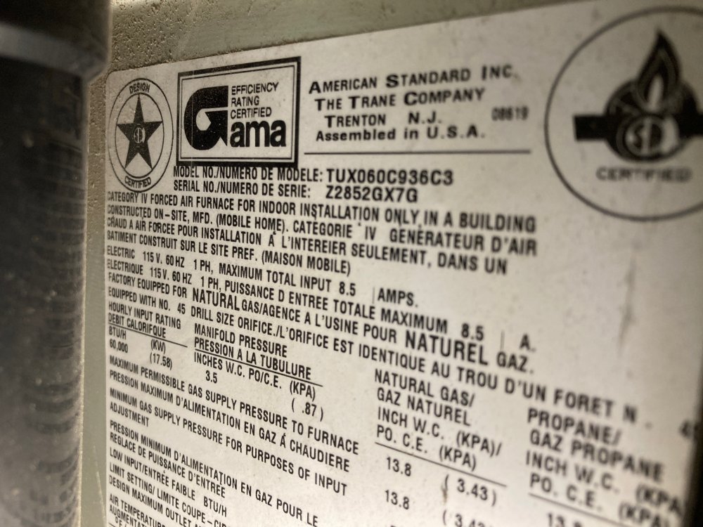

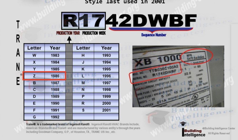

  24. Apparently, building-center.org has S and Z in the wrong position in their key. It's a 2001. Nothing to see here.
