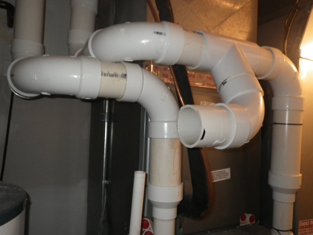

  19. Hey Mark, no, not to augment anything. And, you can't take intake air from the garage with the furnace closet located solely in the garage; if a car is warming up in the garage, automobile-generated CO could be drawn through the ductwork into the living areas
  20. The gas-fired furnace and hot water heater are located in a garage closet. Zero air-intake source from the garage. Took me a while to figure out why the furnace's exterior air intake flue pipe had been *tee'd* with an open-end pipe stub. Do you know why?
