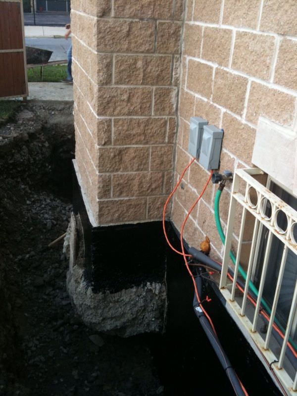

Jeff Beck Posted August 10, 2010 Report Share Posted August 10, 2010 Is it permissible to support a masonry chimney chase with a 24" poured concrete foundation that's attached to the house foundation with rebar? The location is Chicago and the frost line is 45". I don't have any pictures, a sewer contractor that's working on my daughter's house called me today and said that he had never seen anything like this before. There are no wing walls or a 45 degree wall that rests on the footing. The chase is approximately 24' high and 48" wide. Jeff Link to comment Share on other sites More sharing options...

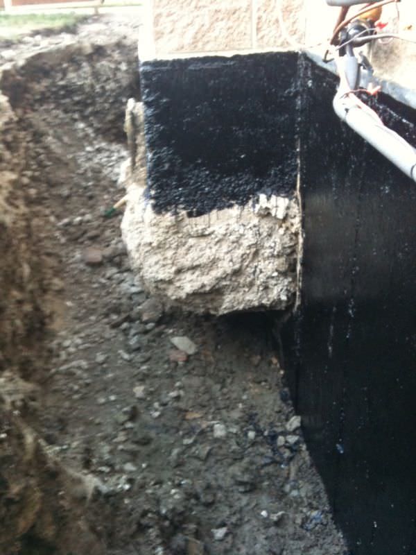

Jeff Beck Posted August 12, 2010 Author Report Share Posted August 12, 2010 Thanks Mike, I was hoping to get lucky and find someone who had seen something like this before. I was able to get to the site early today and have taken some pictures. Here are some establishing shots: Split face masonry chimney chase: Click to Enlarge 70.36 KB Lower portion of the chase: Click to Enlarge 87.61 KB Exposed lower portion of the chase: Click to Enlarge 80.44 KB The foundation for the house goes down another 24" below grade. Every masonry chimney chase that I've seen is supported by either wing walls or a bump out pocket in the foundation so that the load of the chimney is carried down to the spread footings. Occasionally, I'll see support walls that cut back to the foundation at a 45 degree angle. I have never seen anything like this before. As I said in my original post, the frost line in Chicago is 45". The base of this chase terminated well above the frost line. My concern is that there may not be enough of a base to carry the load of the chase and secondly because of the depth to counteract frost heave. This builder has taken numerous short cuts (as evidenced by the washed-out sewer line in a 3 year old house) so I am being overly suspicious of anything I find. I'd really appreciate any comments if this is suspect and if so where I might go to find a code reference (if one exists) or if I'm making a mountain out of a mole hill. Thanks, Jeff Link to comment Share on other sites More sharing options...
Tom Raymond Posted August 12, 2010 Report Share Posted August 12, 2010 Well, it is a mountain now that it's been undermined. Edit: If the place is only 3 years old the plans should be on file. Sounds like you might want to go get a copy of them. Link to comment Share on other sites More sharing options...
mgbinspect Posted August 12, 2010 Report Share Posted August 12, 2010 Well, I'm not an engineer, but if the concrete shelf is original work poured into the concrete foundation, which it appears to be, I wouldn't be too concerned. The photo you posted scales approximately 36" of vertical steel reinforced concrete before transitioning to the masonry chase. That's pretty substantial. Then the work above is tied together through the interlocking nature of masonry, so the entire support has to fail, before it becomes a serious event. Do keep in mind it's not a solid masonry chimney, which would be considerably heavier. It's merely a masonry chase, which is still heavy. It's pretty difficult to imagine a failure based upon those photos. Also, keep in mind that a spread concrete footing is important when the soil is the reciever of the weight above, but that does not appear to be the case here. Link to comment Share on other sites More sharing options...
Marc Posted August 12, 2010 Report Share Posted August 12, 2010 Given the financial consequences of a failure of any type involving that chase, I'd immediately punt to an engineer and get that burden off of my shoulders. Marc Link to comment Share on other sites More sharing options...
