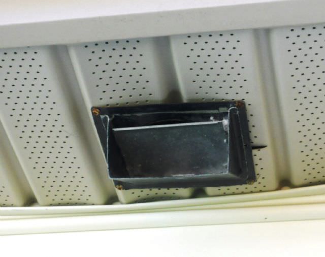

mgbinspect Posted September 4, 2010 Report Share Posted September 4, 2010 Here's another first - The photos below are of the vent hoods for the half bathroom and microwave exhaust fan, both of which vent through the soffit. Obviously, these flapper style vent covers aren't going to function as intended when installed at the underside of a soffit. I'm really not crazy about the kitchen exhaust fan venting this way because it's difficult to confirm that the junctions are airtight. In fact it's doubtful that they are. While I toy with the wording of the deficiency, I am wondering if anyone is aware of a similar self-closing vent cover that is well suited for this location? I suppose one could always turn them out ninety degrees and keep the current vents, but is would be ugly. Any thoughts? Click to Enlarge 23.39 KB Click to Enlarge 37.5 KB Link to comment Share on other sites More sharing options...
Jim Katen Posted September 4, 2010 Report Share Posted September 4, 2010 http://shop.dryerbox.com/s.nl/it.A/id.32/.f http://www.heyokasolutions.com/Soffit_I ... sv2801.htm Link to comment Share on other sites More sharing options...
mgbinspect Posted September 4, 2010 Author Report Share Posted September 4, 2010 http://shop.dryerbox.com/s.nl/it.A/id.32/.f http://www.heyokasolutions.com/Soffit_I ... sv2801.htm Just what the doctor ordered - very nice. Thanks Jim. Link to comment Share on other sites More sharing options...
