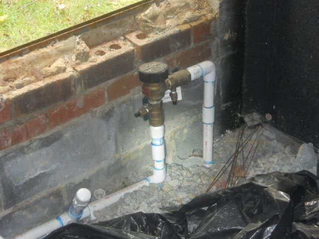

mgbinspect Posted October 22, 2010 Report Share Posted October 22, 2010 Greetings all! I'm calling on the brain-trust for a little help. Last week, I called out a backflow prevention device on a lawn sprinkler system as being the wrong design for the application. My opinion was based upon some old (dusty) information. And, the relocation company is refusing to "further evaluate" unless I can give them more definitive information regarding my opinion. I've been googling to find information to support my opinion/suspicion. I'm pretty sure I'm right, but not yet thoroughly convinced. So, I'm teeing this subject up for a couple of reasons: 1. To get confirmation that I'm on target 2. So information on the subject is available to others Here is the backflow prevention device in question: Click to Enlarge 52.79 KB This particular unit is located in a crawl space - considerably below over half of the sprinkler heads - by as much as ten feet in some cases. Now, it is my understanding that this style of backflow prevention device (with an apparent air gap design) is NOT to be used below sprinkler heads, and must be a minimum of 12" above the highest head. Here is a link to "similar" unit, but not the exact unit. Unfortunately, the system is an hour and a half away and I didn't realize I might need to have the actual unit manufacturer and model number. I actually don't think it will be necessary, as "air gap' style units, in general, fall under this restriction (I think... that's why I'm here... to find out for sure). Here is a great general information link from the EPA that might be useful in our library. In short, it's my understanding that when the device is below the heads, "Pressure Vacuum Breakers" are not suitable. In such cases, "Reduced Pressure Principle Assembly", or possibly the "Double Check Valve" design, is required. But, the EPA document doesn't clearly spell that out. (The first link above, however, does). So there you have it. What I'm hoping for is that one of you guys is intimately familiar with lawn irrigation systems and can nail this one down for time and eternity. A simple confirmation will be nice, but I think that, if anyone is so versed, a thorough educational response about this subject, in detail for the sake of readership, would be FANTASTIC! As always, thanks in advance for your assistance and I hope the general readership benefits from the thread. All the best, Mike Quote Link to comment Share on other sites More sharing options...
fyrmnk Posted October 22, 2010 Report Share Posted October 22, 2010 Now, I don't do sprinkler inspections so I'm certainly not trying to imply I have knowledge of your issue, however the EPA document references ASSE Standard 1020 for information on PVBs. Here's a link where that can be purchased, and in the description of it, it states they can't be used where backpressure on the assembly can be present. I would think head pressure from higher sprinkler heads would count as that, but not sure. Here's the link to the standard: http://stores.assewebstore.com/-strse-1 ... Detail.bok Quote Link to comment Share on other sites More sharing options...
Scottpat Posted October 22, 2010 Report Share Posted October 22, 2010 The vacuum breaker on a lawn irrigation system must be no less than 6" above the highest sprinkler head. Now where that is printed, I do not know..... Quote Link to comment Share on other sites More sharing options...
charlieb Posted October 22, 2010 Report Share Posted October 22, 2010 Bad install. Must be 12" above highest outlet. That device is subject to siphoning. backpressure (been a long time since I sold the stuff) Quote Link to comment Share on other sites More sharing options...
mgbinspect Posted October 22, 2010 Author Report Share Posted October 22, 2010 The vacuum breaker on a lawn irrigation system must be no less than 6" above the highest sprinkler head. Now where that is printed, I do not know..... Yet, there is a style of backflow preventer that is suitable when installed below the heads. So, it's not an all inclusive rule. I take it you are referring to the design I have in my photo, as opposed to a different design? Quote Link to comment Share on other sites More sharing options...
mgbinspect Posted October 22, 2010 Author Report Share Posted October 22, 2010 Bad install. Must be 12" above highest outlet. That device is subject to siphoning. That's what I'm thinking, but there is a device that could be installed in that location, Yes? My biggest problem is that I'm going on probably twelve year old info from a lawn sprinkler guy I spoke to on site... Quote Link to comment Share on other sites More sharing options...
charlieb Posted October 22, 2010 Report Share Posted October 22, 2010 Looks like a watts device http://www.nobackflow.com/irrigpam.htm Quote Link to comment Share on other sites More sharing options...
mgbinspect Posted October 22, 2010 Author Report Share Posted October 22, 2010 Looks like a watts device http://www.nobackflow.com/irrigpam.htm Hmm... that link suggests that EVERY style must be above the sprinkler heads. Can that be right? I see them below the heads, quite often - just not the design in the photo... On second look, I see that what you posted is PERFECT! I didn't notice that the reference point on some of the devices was the earth and not the heads. And, what is equally invaluable - I see "DOUBLE CHECK VALVE ASSEMBLY (DCVA)" units all the time. I had no idea that they're no longer allowed. And, since many areas of the country require an annual inspection of the device, we should probably be calling out the presence of such units. A report modification is in order! THANK YOU CHARLIE! YOU ROCK! Quote Link to comment Share on other sites More sharing options...

Scottpat Posted October 22, 2010 Report Share Posted October 22, 2010 From the IRC P2902.5.3 Lawn irrigation systems. The potable water supply to lawn irrigation systems shall be protected against backflow by an atmospheric-type vacuum breaker, a pressure- type vacuum breaker or a reduced pressure principle backflow preventer. A valve shall not be installed downstream from an atmospheric vacuum breaker. Where chemicals are introduced into the system, the potablewater supply shall be protected against backflow by a reduced pressure principle backflow preventer. The height for the valve above the system or sprinkler head is not given in the IRC. I guess it defaults to the manufacturer? Quote Link to comment Share on other sites More sharing options...

mgbinspect Posted October 25, 2010 Author Report Share Posted October 25, 2010 For anyone that might be interested: The outstanding document Charlie put up, points out that the double check-valve system backflow preventer is no longer permitted on residential lawn irrigation systems. I had the good fortune of speaking with an irrigation guy today, and learned why those units are no longer approved. The reason is actually a pretty big deal to HIs, so getting familiar with that unit might be prudent. I see them often. The double check-valve system worked fine, but when it fails, there is no visible or apparent sign of failure. It simply becomes an instant undetectable cross-connection! And, since it was designed to permit the introduction of chemicals to the sprinkler system, this can be a REAL problem. The newer reduced pressure system, has a relief valve that begins to dribble or flow when the unit fails. (brief minor intermittent flow is normal, but constant dribble or flow indicates failure). Quote Link to comment Share on other sites More sharing options...
