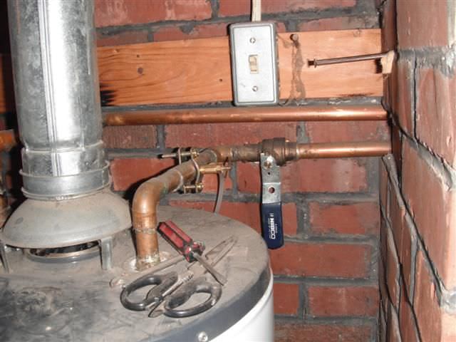

Tim H Posted February 21, 2011 Report Share Posted February 21, 2011 This house was built in 1925. The lime mortar has a light brown-tan color that is what I am used to seeing around here. When I flaked a little away, the mortar underneath is dark, almost black. It was like this all over, not just next to the portland cement covered rowlock sill. Except for the blown lintels and typically horrible portland cement repairs/repointing, the walls were in pretty good shape. Click to Enlarge 56.99 KB Any idea what is going on? Thanks, Tim Quote Link to comment Share on other sites More sharing options...

AHI in AR Posted February 21, 2011 Report Share Posted February 21, 2011 I suspect that what you are seeing is two layers of newer mortar on top of the original one -- at least in places. Around here, colored mortar was quite popular in the 20's and early to mid 30's. My guess is that some repointing was done at an earlier point. It may have been done to cover up the colored mortar since it was now an indication of an "older" style that was not currently in vogue. Additional repointing may have been done later for more substantial reasons, such as deterioration. But based on only one pic, who knows? Have any more photos? Quote Link to comment Share on other sites More sharing options...

kurt Posted February 21, 2011 Report Share Posted February 21, 2011 Like AHI said, it was probably pointed over with a different mortar. Black (well, more like grey-black) mortar is fairly common. Someone decided to redecorate....(?)... Quote Link to comment Share on other sites More sharing options...

Tim H Posted February 21, 2011 Author Report Share Posted February 21, 2011 I suspect that what you are seeing is two layers of newer mortar on top of the original one -- at least in places. Around here, colored mortar was quite popular in the 20's and early to mid 30's. My guess is that some repointing was done at an earlier point. It may have been done to cover up the colored mortar since it was now an indication of an "older" style that was not currently in vogue. Additional repointing may have been done later for more substantial reasons, such as deterioration. But based on only one pic, who knows? Have any more photos? I went back to find more photos and I found this pic of what was originally an exterior wall (before they closed in the porch) that still had the black mortar. Click to Enlarge 53.86 KB Here is a pic of the exterior showing the tan mortar (and a really bad repair job under the window). Click to Enlarge 56.08 KB And another of the mortar around a portland cement repair at a lintel. Click to Enlarge 45.25 KB I didn't think that the entire house had been repointed because the tan layer was so thin in the places that I checked, but after looking again, I think you may be right. Thanks to all. Tim Quote Link to comment Share on other sites More sharing options...
Tom Raymond Posted February 21, 2011 Report Share Posted February 21, 2011 Am I the only one who thinks that brick was laid by someone other than a mason? The bond is all over the map, the rowlock sills are dead flat, the soldiers at the floor platform aren't level or plumb, and a real bricky would have storied the courses to land at the window heads - not cut the brick around the lintel. Given all the other mistakes in that veneer, it might have been pointed in an effort to get all the mortar one color. Quote Link to comment Share on other sites More sharing options...
Tim H Posted February 21, 2011 Author Report Share Posted February 21, 2011 Am I the only one who thinks that brick was laid by someone other than a mason? The bond is all over the map, the rowlock sills are dead flat, the soldiers at the floor platform aren't level or plumb, and a real bricky would have storied the courses to land at the window heads - not cut the brick around the lintel. Given all the other mistakes in that veneer, it might have been pointed in an effort to get all the mortar one color. You are correct. The house was built by the sellers grandfather, who was a farmer and barn builder. You may have noticed that the type of bricks aren't consistent throughout either. Also very unusual for a house of this age, in this area, was the poured concrete foundation walls and piers (combination basement/crawlspace). Some of the issues with the soldiers were caused by the failed lintel at the basement window well underneath. Some, not all. Tim Quote Link to comment Share on other sites More sharing options...
