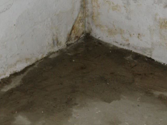

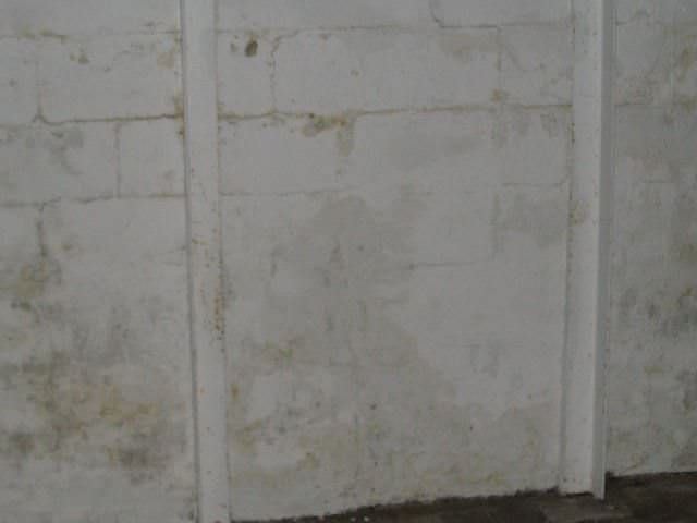

Terence McCann Posted June 22, 2011 Author Report Share Posted June 22, 2011 A home here in Chagrin Falls. Stone and Terra Cotta foundation. More layers of waterproof paint that you can shake a stick at. Moisture problems are rampant in the basement. Front wall has a horizontal crack that was braced at some point in time. Maintence wasn't the best of terms. More like the care and feeding of. Don't paint, try to mount a big screen TV etc. I know there was some discussion on why not to use waterproof paint, especially with terra cotta, but I'm hitting dead ends. Was looking for authoritative source. First stop was the basement because I needed to retrieve my Radon detector. From there it was downhill. The inspection was halted while finding problems with the roof. Click to Enlarge 23.72 KB Click to Enlarge 36.4 KB Click to Enlarge 30.96 KB Quote Link to comment Share on other sites More sharing options...

Bill Kibbel Posted June 22, 2011 Report Share Posted June 22, 2011 Not much that I can add to what you already know. The conditions affecting that basement would have been detrimental to any material used for foundations at that time. Just like skin-fired brick foundations, applying "waterproof" paint or other sealers on the basement side of the walls just traps the water and saturates the material. The original of the image you requested is too large to post here, so I uploaded it at: http://historicbldgs.com/struc_tc_anchors.jpg If you like to collect stuff like that image, and/or inspect a lot of structural TC buildings, try to find a copy of Fireproof houses of "Natco" hollow tile and how to build them. Quote Link to comment Share on other sites More sharing options...
