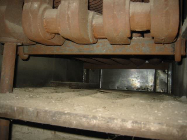

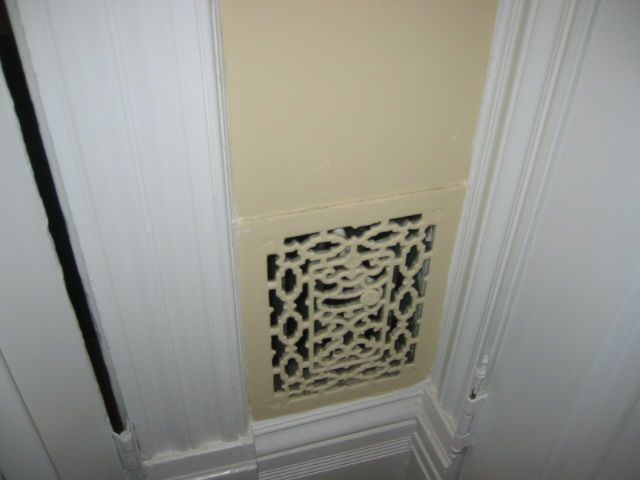

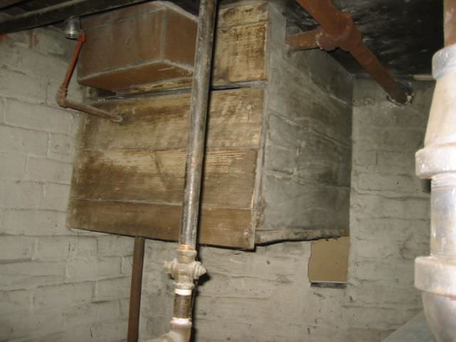

Inspectorjoe Posted July 16, 2011 Report Share Posted July 16, 2011 Today's house was 5,149 sq. ft; built 1882. The steam boiler heated radiators (some really cool) in most of the rooms, but a few rooms were heated by a strange gravity warm air system. Wood enclosures in the basement contain cast iron convectors that are ducted to wall registers on the first and second floors. I can't see how the rooms heated by the convectors in the basement will be as warm as the rooms heated by radiators. That will be in the report. I'm curious though, about why this convector/duct system was used, instead of just using radiators like the other rooms. Anybody have an idea? Click to Enlarge 43.9 KB Click to Enlarge 36.46 KB Click to Enlarge 26.26 KB One of the cool radiators: Click to Enlarge 31.79 KB Quote Link to comment Share on other sites More sharing options...

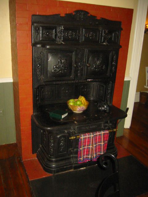

Inspectorjoe Posted July 17, 2011 Author Report Share Posted July 17, 2011 Pretty neat, I'm jealous, never get to see houses of that vintage. Not to rub it in John, but the house still had its original kitchen stove. Click to Enlarge 47.25 KB And gas lites. Click to Enlarge 26.92 KB The basement was pretty cool (or kewl) too. Instead of beams and columns, there were two arched walls. Click to Enlarge 44.33 KB One explanation I can come up with is that a wall register take up less space than a big old radiator. The rooms were big so space wasn't a problem. Woodwork is easier for some people than plumbing. There were hundreds of feet of pipe installed - another three or four dozen wouldn't have made much of a difference. The steam or hot water heat gets less efficient with longer pipe runs, so the designer kept the plumbing runs shorter that way. You might be on to something with that, but the opposite. The rooms with the ducts were in rooms above the boiler and the radiators were further away. There were no turns in the ducts, as far as I could tell. Quote Link to comment Share on other sites More sharing options...

Inspectorjoe Posted July 19, 2011 Author Report Share Posted July 19, 2011 Two of the rooms supplied are bedrooms and as far as I could tell, the radiators in the boxes were never supplied with outside air. I guess the 'why' of this one will remain a mystery. Quote Link to comment Share on other sites More sharing options...

Inspectorjoe Posted July 20, 2011 Author Report Share Posted July 20, 2011 Marc, all convector units have radiators in them. They use fins to give a greater surface area, resulting in faster heat transfer. Modern convectors generally use copper tubing with aluminum fins. The one in the wood enclosure was cast iron. It was built up in sections connected with threaded nipples. Click to Enlarge 42.96 KB While most room radiators are just smooth cast iron, the house the basement convectors were in had some unusual finned room radiators. Click to Enlarge 43.02 KB Quote Link to comment Share on other sites More sharing options...
