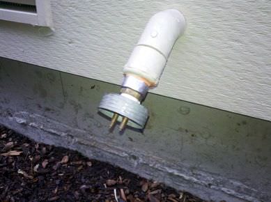

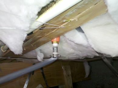

Lasswell Posted March 4, 2012 Report Share Posted March 4, 2012 I was inspecting a new house and I am pretty certain the drain line for the sprinkler system is not put together correctly. In the crawlspace a short galvanized nipple was threaded into the CPVC and then had flexible tubing hose clamped to it. The tubing made and immediate 90 degree bend and is kinked. It had no support where it ran across the crawlspace and then was hose clamped to a section of copper pipe which threaded into CPVC which exited to the exterior. Does anyone know the code requirements for material for the drain line on a fire sprinkler system? Also this was threaded into the exterior termination of the drain line. Anyone know what this is? Thanks John Download Attachment: Fire Sprinkler.jpg 44.59 KB Click to Enlarge 16.33 KB Click to Enlarge 23.49 KB Quote Link to comment Share on other sites More sharing options...
hausdok Posted March 4, 2012 Report Share Posted March 4, 2012 Those are so far outside the scope of what we do that you shouldn't even waste time worrying about it. Post the picture of the kinked pipe along with a header something like, "Get the fire suppression system checked out" and simply explain that you suspect that the kinked line is an issue for that system but don't know because inspectors aren't trained on those systems; and then move on to the next thing. ONE TEAM - ONE FIGHT!!! Mike Quote Link to comment Share on other sites More sharing options...
Tom Raymond Posted March 5, 2012 Report Share Posted March 5, 2012 Mikey, it's fire supression. It's in the new IRC and should be on our radar. It would make a really good CE topic. John, it's a drain. If it looks fooked up it is. Tell 'em to get it fixed. Quote Link to comment Share on other sites More sharing options...
