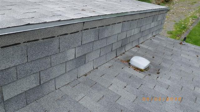

Robert Jones Posted May 3, 2012 Report Share Posted May 3, 2012 This beauty is a carport attached to a double wide manufactured. I was cracking up... Click to Enlarge 67.39 KB Click to Enlarge 58.17 KB Quote Link to comment Share on other sites More sharing options...
Erby Posted May 3, 2012 Report Share Posted May 3, 2012 So they forgot the finish course on the vertical wall. Bummer. Was it supported by the MH. Quote Link to comment Share on other sites More sharing options...
Brandon Whitmore Posted May 3, 2012 Report Share Posted May 3, 2012 Attached to the home wouldn't be an issue. Supported by the home would definitely be a concern. Quote Link to comment Share on other sites More sharing options...
Robert Jones Posted May 3, 2012 Author Report Share Posted May 3, 2012 Yes supported by the home. Quote Link to comment Share on other sites More sharing options...
