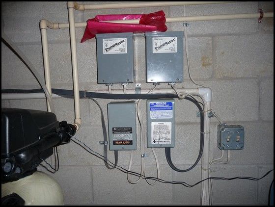

John Dirks Jr Posted July 14, 2012 Report Share Posted July 14, 2012 Two active wells. The first time I've seen this. Have you ever seen two well setups in the same house? 1993 build. Click to Enlarge 47.26 KB Click to Enlarge 49.44 KB Click to Enlarge 39.04 KB Link to comment Share on other sites More sharing options...
Charlie R Posted July 14, 2012 Report Share Posted July 14, 2012 They might have had a flow problem - too few gallons per minute. Unusual set up, I've only see it twice, but I don't see anything wrong as long as you have both well caps/heads accessible. Link to comment Share on other sites More sharing options...
Tom Raymond Posted July 14, 2012 Report Share Posted July 14, 2012 I built one that had two wells and still had recovery issues. We ended up with a 600 gallon holding tank and a timer arrangement with a high/low float override. Link to comment Share on other sites More sharing options...
MMustola Posted July 14, 2012 Report Share Posted July 14, 2012 It's very common in an area of my county where the availability of ground water is very poor. At a depth where water in plentiful the water is too salty to use. The usable water is very shallow, about 20 or 30 feet deep, but it is basically surface runoff. In order to get an adequate volume they have to drill two shallow wells separated from each other at different ends of the property. Link to comment Share on other sites More sharing options...
