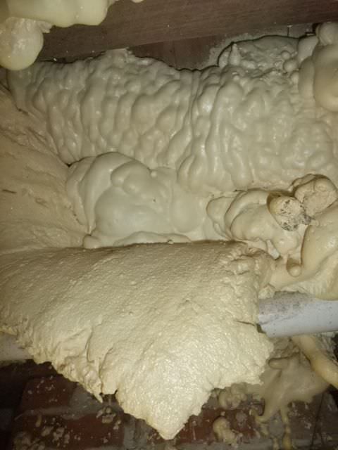

Marc Posted July 30, 2012 Report Share Posted July 30, 2012 Yesterday's house had a horrible mess of SPF between the floor joists in an open crawl. This is a hot/humid climate and Dr. Joe advises no insulation there. I've written up most points about it but I'm unsure about the sub-termite/polyurethane angle. Do sub-termites eat polyurethane? Marc Click to Enlarge 53.48 KB Click to Enlarge 46.08 KB Quote Link to comment Share on other sites More sharing options...
AHI in AR Posted July 30, 2012 Report Share Posted July 30, 2012 I've never seen anyone do foamed joist cavities here so I haven't researched it. But I would suspect that while they can't actually eat/digest the foam, I would bet it's likely that they can tunnel through it. They do through Styrofoam/EPS, anyway. Is that a new home? Considering that it's a brick foundation and it looks like it's possibly a rough sawn floor joist I see, I have to assume that it is an older home. And if it is, who's to say what sort of damage they covered up with the foam? Quote Link to comment Share on other sites More sharing options...
Marc Posted July 30, 2012 Author Report Share Posted July 30, 2012 Built around 1905. The SPF was done around 2006. The stinkin' workmanship isn't limited to the SPF. It's there on the electrical/plumbing upgrades, developed attic and a rear addition, all done at the same time. Not a flipper. This was a very sturdy and fine house. It's a sad story that I'll have to give my buyer. Marc Quote Link to comment Share on other sites More sharing options...
Scottpat Posted July 30, 2012 Report Share Posted July 30, 2012 Marc, I would not even address the termites unless you are also doing a termite inspection. Let the PC contractor worry about that with the foam mess you have in those pictures. While I do not agree with everything that Dr Joe says, I do agree about the subfloor insulation in the South. I have seen more problems with subfloor insulation in the South than any good that it could provide. Now with foam, I have not idea if it could cause the same issue as fiberglass batts but my bet is that it could. Quote Link to comment Share on other sites More sharing options...
ghentjr Posted July 30, 2012 Report Share Posted July 30, 2012 Do sub-termites eat polyurethane? Marc No but they love to tunnel through and behind it. Holds moisture and warmth. Quote Link to comment Share on other sites More sharing options...
