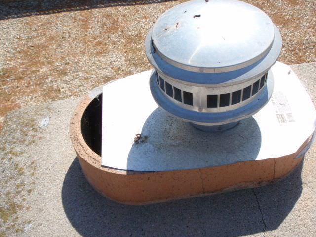

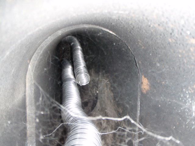

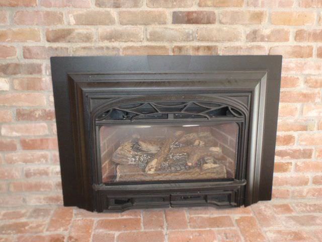

inspectorwill Posted August 21, 2012 Report Share Posted August 21, 2012 This masonry fireplace has been retrofitted with a metal gas only fireplace insert with a metal vent pipe presumably because the visible chimney cracks extended into the clay flue liner. Question is - shouldn't this fireplace get combustion air from the outside or is it dependent on the manufacturer requirements? From the roof, I could see down into the flue because the installer left a gap in the flue cap and saw a second flexible metal vent pipe that terminated inside the flue. I speculate they left the gap to allow combustion air into the original flue where the second metal vent pipe is located. See pics for detail. Last pic is through the gap in the cap looking down into flue. Click to Enlarge 52.12 KB Click to Enlarge 63.54 KB Click to Enlarge 49.97 KB Link to comment Share on other sites More sharing options...
Phillip Posted August 22, 2012 Report Share Posted August 22, 2012 They should of run the fresh air on out. This set up is going to let rain get in and as you know water will do damage. Link to comment Share on other sites More sharing options...
hausdok Posted August 22, 2012 Report Share Posted August 22, 2012 Hi, I agree, the opening is for combustion air and that's the air inlet pipe in the flue. I doubt that you'll get much water in there. We have chimneys wide open here without covers on them in arguably one of the rainiest places in the country and we don't see a lot of water getting in wide open flues. I doubt much rain will get in there and what little does will probably evaporate very quickly - even if it doesn't, it will drain through the floor of the original fireplace into the ash sump. ONE TEAM - ONE FIGHT!!! Mike Link to comment Share on other sites More sharing options...
inspectorwill Posted August 22, 2012 Author Report Share Posted August 22, 2012 Thanks gentlemen. I am not as concerned about water getting in the flue being in Santa Barbara where we get little rain as much as the overall installation looking amateur and the fresh air opening looking a bit small. I'm overly cautious with installation of gas operated appliances. Link to comment Share on other sites More sharing options...
John Kogel Posted August 23, 2012 Report Share Posted August 23, 2012 I don't think you are overly cautious with that installation. It is a hack job that allows flue gases to be sucked back through the fire. This could cause incomplete burning and soot buildup. Good catch. Link to comment Share on other sites More sharing options...
