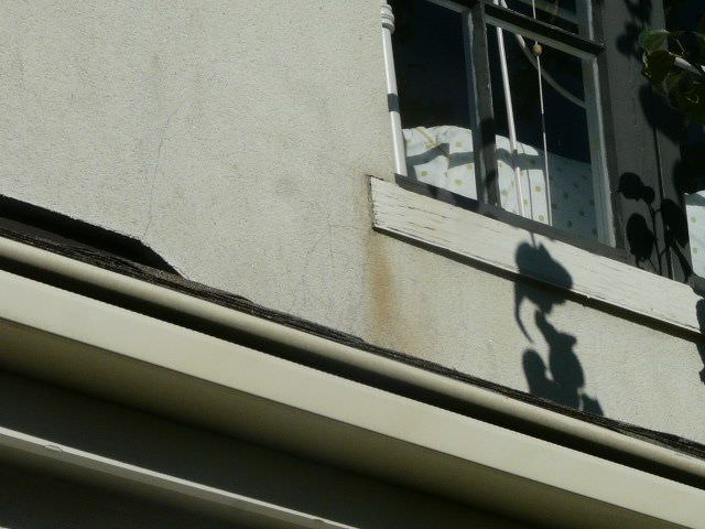

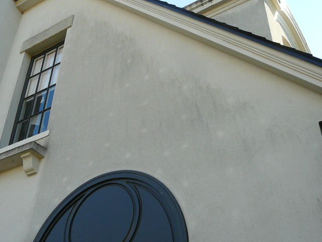

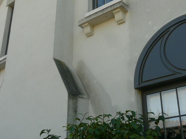

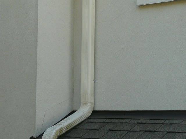

tybertown29 Posted September 19, 2012 Report Share Posted September 19, 2012 I recently did an inspection on a 1924 house that had EIFS installed on it approximately 10 years ago. There are wood widow sills left in place, cracking in the finish coat every 4 feet (the size of the Panels) and I can see the fasteners radiating out through the finish coat. I recommended further evaluation by an EIFS inspector but was wondering what any of you think of what I am seeing. Looks to me like failure around the house.[:-monkeyd Click to Enlarge 37.52 KB Click to Enlarge 35.73 KB Click to Enlarge 30.58 KB Click to Enlarge 55.34 KB. Quote Link to comment Share on other sites More sharing options...
John Kogel Posted September 19, 2012 Report Share Posted September 19, 2012 I'm afraid you are right. It is trouble that will require big bucks to repair, basically tear it all off. One good thing is that the original plank sheathing may still be ok. The old wood can handle a bit of wet, and the wall cavities are probably hollow. Quote Link to comment Share on other sites More sharing options...
Marc Posted September 19, 2012 Report Share Posted September 19, 2012 How's the inside of the house? Marc Quote Link to comment Share on other sites More sharing options...
tybertown29 Posted September 19, 2012 Author Report Share Posted September 19, 2012 Interior has all been redone. New drywall, electrical, and insulation. Quote Link to comment Share on other sites More sharing options...
Marc Posted September 19, 2012 Report Share Posted September 19, 2012 I'd write it up each deficiency in the exterior finish, explaining why each was a problem and what could happen but without any actual damage to back me up, I don't feel justified in recommending it all come off. If XPS was exposed in a few places, that alone would be enough. As bad as it looks in the pictures, it shouldn't be hard to find something somewhere to use. Marc Quote Link to comment Share on other sites More sharing options...
