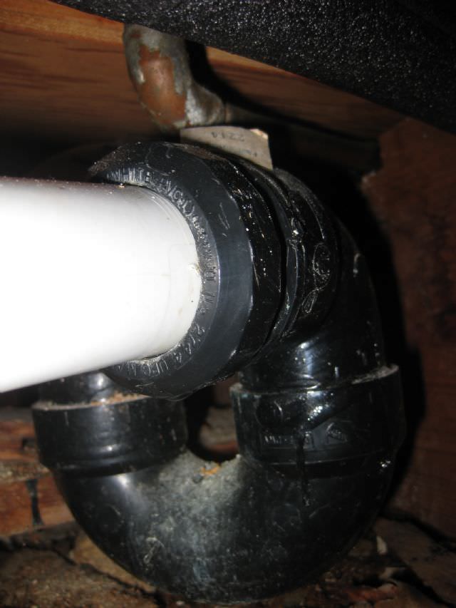

cactuscake Posted September 22, 2012 Report Share Posted September 22, 2012 In February this year the drain under my tub started leaking. There was quite a mixture of pipes - brass fittings attached to the tub, a chromed copper pipe leading from the bottom of the brass fittings making its way to the black plastic coupling in this picture. The metal had corroded at both ends of the chrome middle section and we had a plumber replace as much as he could with white PVC, it took about 2 hours because of the awkward space. Unfortunately the joint between white and black has started leaking again and I'd like to fix it. I can't tell what type of plastic the black section is though. What I can see of the text says "...WHITE PVC-I) (off-DWV U 1 1/2 2744 UFC MA..." it is in an incredibly awkward space and it was only by sticking the camera into a hole and taking a snapshot that I was even able to get an idea of where the leak was coming from. Other than that the repairs will need to be done by feeling around. Click to Enlarge 60.54 KB I'm trying to figure out if I can just reglue the joint and if so, whether I'll need some of the green transition stuff, or if purple will work just fine. Any ideas? Quote Link to comment Share on other sites More sharing options...

Bill Kibbel Posted September 22, 2012 Report Share Posted September 22, 2012 If it's leaking where white meets black, it's a trap adapter - not a solvent joint. Click to Enlarge 8.32 KB Rotate the black ring with the ribs to the right to tighten the compression ring around the PVC pipe. Quote Link to comment Share on other sites More sharing options...

cactuscake Posted September 22, 2012 Author Report Share Posted September 22, 2012 Aha! Bill I think you're right. I tried to tighten it by hand (can't really get any tools in there) and it's already pretty stiff. But if that doesn't work I can probably get a new one. Thank you! [:-slaphap Quote Link to comment Share on other sites More sharing options...

cactuscake Posted September 22, 2012 Author Report Share Posted September 22, 2012 Turns out it was indeed a trap adapter, and upon further testing the leak was coming from the next joint up and running down to this one. I discovered that when the plumber had switched out the old metal piping for PVC, one of the pieces was cut too short. He had tugged it all together and the screw fittings were holding at first but the tension proved too much in the end and so it kept slipping apart no matter what I tried. For now I've made a sling out of a trusty wire coat hanger so that the lower section is being pulled up nice and snug against the too-short pipe. Should probably replace the whole set-up again, but I don't feel like doing it today... after all, I'm all showered and cleaned up now! Quote Link to comment Share on other sites More sharing options...
