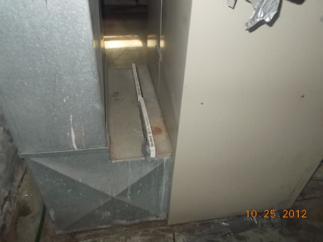

AmeriSpecguy Posted October 25, 2012 Report Share Posted October 25, 2012 Three story home with 2 furnaces. The cold air return ducting was shared as was the supply ducting. There was a single A coil also. I have not seen this before and it leaves me scratching my head. Is there anything wrong with this installation. My establishing shot file was corrupt so this is the only photo that came out. Click to Enlarge 27.92 KB Link to comment Share on other sites More sharing options...
Marc Posted October 25, 2012 Report Share Posted October 25, 2012 Not if the furnaces are twinned. Marc Link to comment Share on other sites More sharing options...
AmeriSpecguy Posted October 25, 2012 Author Report Share Posted October 25, 2012 Thanks Marc! This is a new one on me. I've done homes with multiple systems before but not done this way. Love seeing and learning new things! Link to comment Share on other sites More sharing options...
Rob Amaral Posted October 26, 2012 Report Share Posted October 26, 2012 Wait till you see three..! Link to comment Share on other sites More sharing options...
