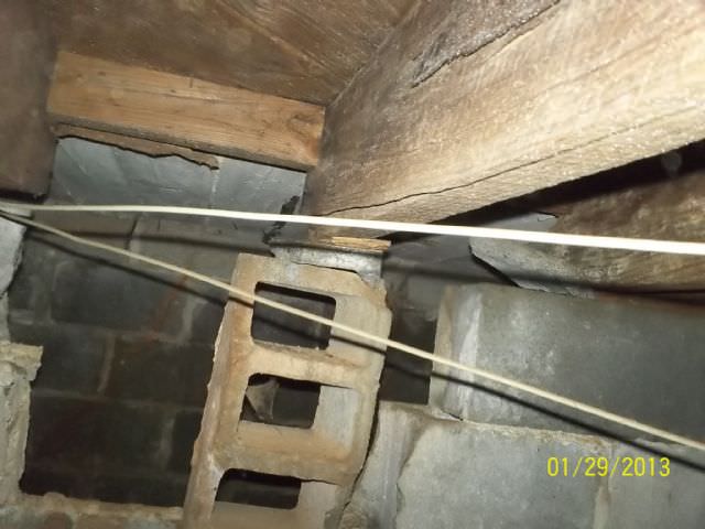

Phillip Posted February 3, 2013 Report Share Posted February 3, 2013 Saw this while I was doing an inspection for the bank based on the wood infestation report. Click to Enlarge 49.68 KB Link to comment Share on other sites More sharing options...
ejager Posted February 3, 2013 Report Share Posted February 3, 2013 It's just holding up the little piece that split from the bottom. Don't worry...be happy! Link to comment Share on other sites More sharing options...
Marc Posted February 3, 2013 Report Share Posted February 3, 2013 Looks like its rotted out at the bearing end, all three in the photo. Marc Link to comment Share on other sites More sharing options...
Phillip Posted February 5, 2013 Author Report Share Posted February 5, 2013 Looks like its rotted out at the bearing end, all three in the photo. Marc Yes but all the bank wanted is what effect the non active/past damage the termite/power post beetle and wood fungus had done Link to comment Share on other sites More sharing options...
John Kogel Posted February 5, 2013 Report Share Posted February 5, 2013 Looks like its rotted out at the bearing end, all three in the photo. Marc Yes but all the bank wanted is what effect the non active/past damage the termite/power post beetle and wood fungus had done Ignorance is bliss, but only if you're stupid. [] Link to comment Share on other sites More sharing options...
