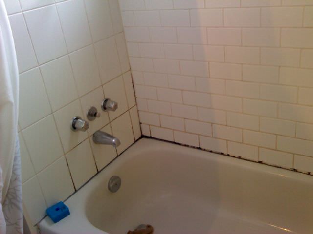

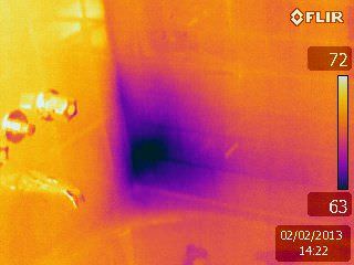

Stephen Lagueux Posted February 10, 2013 Report Share Posted February 10, 2013 I thought I would contribute to this topic with this new thread. When inspecting houses, I often come across bathrooms with presence of mildew around the tub. Loose faucets and spouts will lead to water infiltration inside the walls from the splattering water of the shower. Damaged grout and cracked tiles will also have the same consequence on drywall and framing members behind. For having repaired my own bathroom walls for the same reasons not too long ago, I thought I would post a couple of pictures from a recent inspection. Visual inspection revealed presence of mildew, damaged grout, cracked tiles, loose faucets and spout. A combination of all the clues put together. Using the IR camera, I was able to get this thermo image. One needs to make sure that the surface is dry though and account for high reflectivity of the tiles. The thermal anomaly was confirmed with a moisture meter. Click to Enlarge 23.65?KB Click to Enlarge 13.48?KB Link to comment Share on other sites More sharing options...
David Meiland Posted February 10, 2013 Report Share Posted February 10, 2013 Not sure I'd call that humidity... looks like wet drywall, greenboard, or possibly CBU there. Link to comment Share on other sites More sharing options...
resqman Posted February 10, 2013 Report Share Posted February 10, 2013 Looks like it has been repaired at least once in the past due to different tiles. Link to comment Share on other sites More sharing options...
David Meiland Posted February 10, 2013 Report Share Posted February 10, 2013 Indeed, and the wetness doesn't appear to go around the corner much if at all. Interesting image. Link to comment Share on other sites More sharing options...
Rocon Posted February 11, 2013 Report Share Posted February 11, 2013 Stephen, Is that corner of the tub on an outside wall? I have seen thermal anomalies similar to that where there was an air leak or thermal bridge. I use an inductive moisture meter on tile areas such as that. It is not as accurate as using the meter over wood however by checking several places on a tile surface you can detect elevated moisture. Of course, you must take into consideration wire mesh or hot mop shower pans as they give false elevated readings. Ramon Link to comment Share on other sites More sharing options...
Tom Raymond Posted February 11, 2013 Report Share Posted February 11, 2013 I have literally dozens of images like that indicating fiberglass insulation that was wet before, but not at the time I took the image. The insulation collapses under the weight of the water and never rebounds. Link to comment Share on other sites More sharing options...
Scottpat Posted February 12, 2013 Report Share Posted February 12, 2013 He said he confirmed it with a moisture meter....... Link to comment Share on other sites More sharing options...
Stephen Lagueux Posted February 12, 2013 Author Report Share Posted February 12, 2013 yes, that is the outside wall. There is a crack in the grout in the corner which is too small to see on that picture. Yes, when using a moisture meter, I always make sur to have a base reference to compare readings. In that case, the wall was checked in several places and I will always check the top section where it is less likely to be affected by humidity. Link to comment Share on other sites More sharing options...
hausdok Posted February 12, 2013 Report Share Posted February 12, 2013 Yeah, It's moisture that's worked its way up behind the tile due to capillary action. It probably isn't in the substrate, wall or framing yet. You don't need an infrared camera for that kind of stuff. rap the tile with your knuckles and use your eyes. If the tile echoes you've got a loose tile. If there are cracks or voids in the grout water will be behind the tile. If the caulk is failing along the tub rim there will probably be water behind the first course. If the corner joint grout is cracked or if it's been caulked and the caulk has failed there will probably be water behind the tiles that meet that corner at either side. I routinely see stuff like that and later on when I check with Yung she confirms that she'd found water behind the tile. Unless it's really old and I have a high expectation of finding drywall or greenboard behind the tile, and it looks like it's been that way for a long time, I wouldn't expect it to have gotten into the wall. ONE TEAM - ONE FIGHT!!! Mike Link to comment Share on other sites More sharing options...
Stephen Lagueux Posted February 12, 2013 Author Report Share Posted February 12, 2013 You're right, one doesn't really need an IR camera. With all them clues, it's pretty much straight forward. I used it for my own amusement to see what kind of thermal pattern I would get, add the image to my library but mostly to plant a seed and get people around me interrested in a possible thermal inspection later on.... Link to comment Share on other sites More sharing options...
