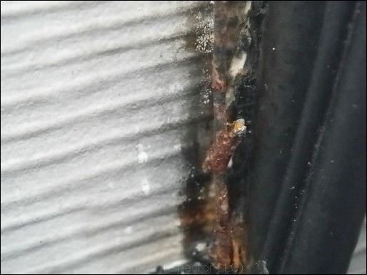

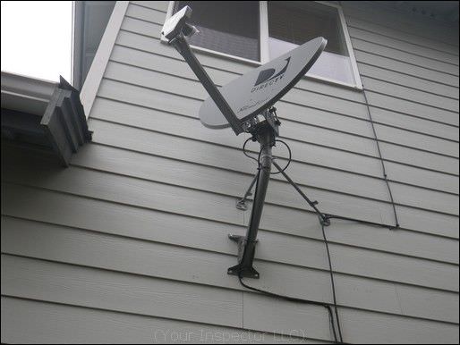

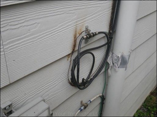

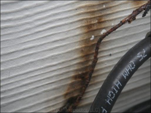

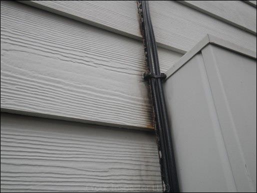

hausdok Posted February 23, 2013 Report Share Posted February 23, 2013 Yesterday's inspection. Click to Enlarge 33.64?KB Click to Enlarge 39.56?KB Click to Enlarge 32.59?KB Click to Enlarge 34.68?KB Click to Enlarge 34.93?KB Click to Enlarge 42.22?KB It's kind of a good thing this was fiber-cement siding versus wood siding or there might have been more than a little scorching on the clapboards. ONE TEAM - ONE FIGHT!!! Mike Link to comment Share on other sites More sharing options...
Jim Port Posted February 23, 2013 Report Share Posted February 23, 2013 The NEC requires a bond to the satellite dish from the GEC. Link to comment Share on other sites More sharing options...
plummen Posted February 24, 2013 Report Share Posted February 24, 2013 Seems like common sense to me to ground a big metal dish on side of your house that's directly connected to a house appliance/entertainment system to me anyway. Im glad I wasn't around the tv/satellite control box when it hit!EEEEEEEEEk[:-taped] Link to comment Share on other sites More sharing options...
Charles46 Posted March 4, 2013 Report Share Posted March 4, 2013 Satellite installations per satellite companies are to bonded and grounded per NEC requirements. From what I can see from these pictures, this install was done per manufactures requirements. The messenger wire (thin wire that is burned) should have been attached to the dish mount via a green self taping screw, and the ground wire(green wire in the last picture) should have gone from the single connection grounding block to ground source, which it appears to have done. Saw an install once that the installer did not bring to the ground source and when lightening hit, not only was the messenger wire fried, but the coax cable, the satellite receiver in the house, the TV it was attached to, a telephone, and an answering machine were all toast. For that reason, I mention it to my clients when I see a system that is not properly grounded. Link to comment Share on other sites More sharing options...
hausdok Posted March 5, 2013 Author Report Share Posted March 5, 2013 Satellite installations per satellite companies are to bonded and grounded per NEC requirements. From what I can see from these pictures, this install was done per manufactures requirements. The messenger wire (thin wire that is burned) should have been attached to the dish mount via a green self taping screw, and the ground wire(green wire in the last picture) should have gone from the single connection grounding block to ground source, which it appears to have done. Saw an install once that the installer did not bring to the ground source and when lightening hit, not only was the messenger wire fried, but the coax cable, the satellite receiver in the house, the TV it was attached to, a telephone, and an answering machine were all toast. For that reason, I mention it to my clients when I see a system that is not properly grounded. Yeah, You're right. I didn't post this to say it didn't have a ground. I posted it to show an example of why a ground was needed. Without the ground it could have been worse. Guess I should have elaborated with some context but folks here get tired of my context so I didn't bother. ONE TEAM - ONE FIGHT!!! Mike Link to comment Share on other sites More sharing options...
