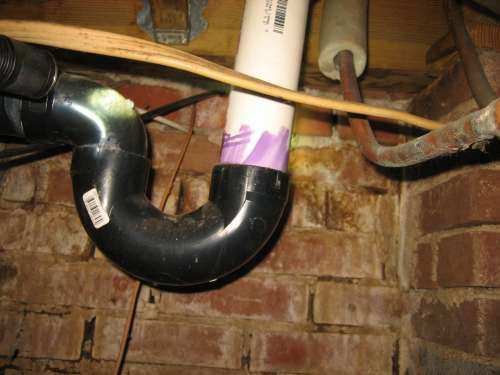

ramdino Posted March 1, 2013 Report Share Posted March 1, 2013 Can these two types of plastic be used together.? They sure were stuck well. Click to Enlarge 31.77?KB Link to comment Share on other sites More sharing options...
Marc Posted March 1, 2013 Report Share Posted March 1, 2013 Check the black pipe for markings. I've heard of PVC fittings that were black or dark-colored. If it's ABS, it's wrong. Marc Link to comment Share on other sites More sharing options...
John Kogel Posted March 1, 2013 Report Share Posted March 1, 2013 The correct glue for transitioning PVC to ABS is Green. I believe the purple glue is incorrect. Here is a link to the correct glue - http://www.homedepot.com/p/Oatey-4-oz-A ... TDOuDchWAk Read about Mycroft's experiments with pipes and glue here: https://www.inspectorsjournal.com/forum ... IC_ID=6428 Some jurisdiction will not allow the green glue, so then you use a Fernco connector. Link to comment Share on other sites More sharing options...
Darren Posted March 1, 2013 Report Share Posted March 1, 2013 According to the New Jersey code interpretation, it is incorrect. Download Attachment: PVCABS.pdf 18.36 KB Link to comment Share on other sites More sharing options...
ramdino Posted March 1, 2013 Author Report Share Posted March 1, 2013 Thanks for the reply. The purple us actually a primer that is required to be slopped on prior to gluing. It is colored so the inspector knows it was performed. Marc is correct, there are black pvc fittings although I have never seen one. Looking at a closeup of the thickness of the pipe on the edge i feel that it might have been pvc, abs is generally thinner material. The joint was tight and no drip marks were on it where it might have been leaking so I think it is ok. Link to comment Share on other sites More sharing options...
rkenney Posted March 1, 2013 Report Share Posted March 1, 2013 Many areas do not use the IRC for plumbing. Maryland uses the NSPC 2009 4.3.9 e. ABS and PVC Plastic Pipe: Solvent cemented non-pressure joints between ABS and PVC DWV piping systems shall be made with an ASTM D3138 solvent cement intended for such transition joints. Transition cement shall not be permitted to be used within buildings. Transition joints shall be a minimum of 3 feet outside of buildings. So it is wrong inside the building. Link to comment Share on other sites More sharing options...

John Kogel Posted March 1, 2013 Report Share Posted March 1, 2013 Guess I got lucky. Posting on this forum sometimes makes me feel like I'm in a casino. Marc The difference is here, you may be out to lunch, but you won't be out of pocket. [] Ramdino, I wouldn't say it is OK, if there is even the slightest doubt. You can't tell from the picture if that is PVC, and it looks like ABS to me. I would say it is wrong, or it appears to be wrong. If you want to add that it is not leaking, do that too. Link to comment Share on other sites More sharing options...
