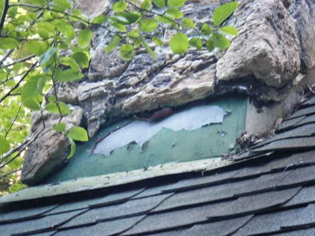

Denray Posted May 2, 2013 Report Share Posted May 2, 2013 Seems fake. Click to Enlarge 71.33 KB Quote Link to comment Share on other sites More sharing options...
AHI in AR Posted May 2, 2013 Report Share Posted May 2, 2013 Well, it's not rock as you'd find lying about on the ground. It's man-made faux stone created from concrete and other components. The installation details are entirely different. If your installers are of the same caliber that I often see here it's likely that it's not installed properly and water damage will result. Quote Link to comment Share on other sites More sharing options...
John Kogel Posted May 2, 2013 Report Share Posted May 2, 2013 Kevin, I think Denny is asking stupid questions for fun, eh? What looks worse, a faux stone chimney or a vinyl siding chimney? Quote Link to comment Share on other sites More sharing options...
Denray Posted May 2, 2013 Author Report Share Posted May 2, 2013 I couldn't get to it. But I just wanted to ID the stone. I'm maybe 1/10th as smart as you guys at this stuff. Fortunately my competitors aren't that brilliant either.[:-paperba Click to Enlarge 83.67 KB Quote Link to comment Share on other sites More sharing options...
kurt Posted May 3, 2013 Report Share Posted May 3, 2013 That looks like this stuff we called "cultured stone". It was one of the first faux stone materials, showed up back in the 80's. Really ugly and just as stupid. Quote Link to comment Share on other sites More sharing options...
Erby Posted May 4, 2013 Report Share Posted May 4, 2013 Denny, The Installation Guide for Adhered Concrete Masonry Veneer, 3rd edition can be found on the website of the Masonry Veneer Manufacturers Association. Make's it easier to pick it apart. I think page 54 has what you want. http://www.masonryveneer.org/pdf/MVMA%2 ... _Final.pdf Quote Link to comment Share on other sites More sharing options...
