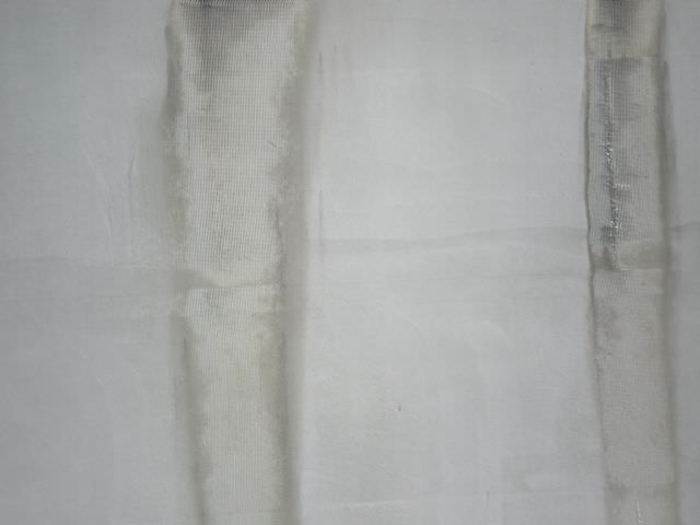

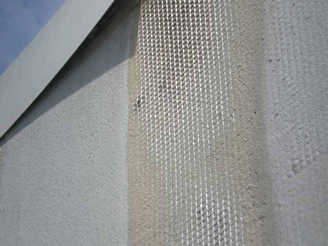

Les Posted August 9, 2013 Report Share Posted August 9, 2013 I don't see much eifs here in my area. I have done a bit of reading, attended some classes, but can't consider myself an expert. I have a single story concrete block commercial building abt 45yrs old. About 10years ago eifs was applied on block (can't see how or why) and looks to be doing what it is supposed to do. Few minor impact spots, but overall pretty good looking. All the areas that can't be seen from the ground have only the fiberglass mesh and a single coat holding the mesh with no finish coat of material. you can see the mesh in abt 90% of surface. Some of the mesh is not secure or covered, just laying there. Can this area be covered with material now? Would the foam likely be deteriorated? etc. Click to Enlarge 67.61 KB Click to Enlarge 23.3 KB how thick should be finish coat typically be? Quote Link to comment Share on other sites More sharing options...

Les Posted August 9, 2013 Author Report Share Posted August 9, 2013 Kurt, can't help but ask - was it Rufus that splained ee fus? I am fairly comfortable with substrate, given what I can see. My concern is the thickness of second coat and the lack of a second coat. I'm really thinking that any tradesperson that skimped on the first layer, certainly cut some other corners. Every visible (easy view) surface looked ok and had second layer. Quote Link to comment Share on other sites More sharing options...
gtblum Posted August 9, 2013 Report Share Posted August 9, 2013 Les, this link might help answer your last question. Any chance it may have been caused by power washing the material away? Take a look at DC014 near the bottom of the doc. http://www.dryvit.com/fileshare/doc/us/ ... /ds498.pdf Quote Link to comment Share on other sites More sharing options...
Marc Posted August 9, 2013 Report Share Posted August 9, 2013 Exposed EPS foam board would have degraded far too much to bond properly with base coat. I'm not aware of any reason why the base coat would no longer be a suitable bonding surface, though irregularities such as exposed mesh should be fixed before applying a finish coat. The manufacturer of the finish coat specifies the appropriate thickness of finish to apply. As Kurt opined, little reason to suspect EIFS-sourced moisture issues when applied to mass-walls such as block. I haven't been updated on EIFS since 2008, so I might be plumb off my rocker. Marc Quote Link to comment Share on other sites More sharing options...
BADAIR Posted August 12, 2013 Report Share Posted August 12, 2013 roof run off occurring at these locations? appears roof run off occurred shortly after base coat was installed erosion vs incomplete/improper app imo moisture analysis would be the first course of action before any remedial work progresses Quote Link to comment Share on other sites More sharing options...
StevenT Posted September 1, 2013 Report Share Posted September 1, 2013 Hello folks, I haven't visited for a while, I hope everyone is doing well. I happened to notice this thread and thought I'd chime in. I think Barry may be onto something, and I agree that the entire envelope should be tested/evaluated. Quote Link to comment Share on other sites More sharing options...
mark parlee Posted November 21, 2013 Report Share Posted November 21, 2013 Haven't been here in a while either. Kurt it's EEE F SSSS That's long E slight F and hold the S there is no short u or short i sound just long E and run the F & S together. Sometimes I pronounce it wrong so people understand what I am talking about. So much for the pronunciation lesson. I am sure the OP has found the answer but if not I would recommend getting a professional evaluation of the EIF system Quote Link to comment Share on other sites More sharing options...
