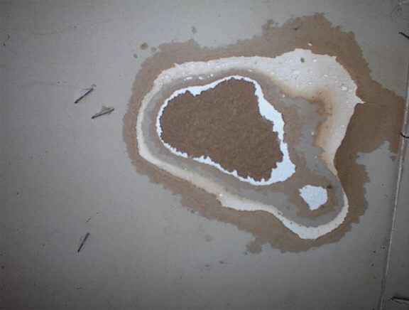

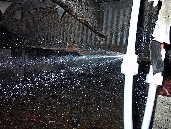

Jim Katen Posted September 26, 2005 Report Share Posted September 26, 2005 Originally posted by excalibur Hi i would like to know if water piping type Poly-B ... polybutylene has been a failure to you part of town ? I know that this type of piping have been a large class action in the U.S So what do you guys recommand to your clients when this type of piping is installed? joneakes.com I've only seen it in one site-built home. It was fine during the inspection and there was no evidence that it had leaked before. However, I've seen it in hundreds of manufactured homes. The PB plumbing system had leaked in lots of them. The highest percentage of failure seems to be in the homes with the acetal fittings rather than the copper fittings. Those systems are distinctly the "worst of the worst" when it comes to PB systems. When I see a PB system that's leaked, I tell my customers to have the house re-piped. When I see a PB system that doesn't show signs of having leaked, I explain the problem and tell them something like, "Understand that there's an above-average risk that the PB plumbing pipes in this house could fail suddenly and cause flooding." - Jim Katen, Oregon Download Attachment: PB_Leak_02.jpg 101.94 KB Download Attachment: PB_Leak_44.jpg 62.45 KB Download Attachment: PB_Scouring.jpg 35.59 KB Link to comment Share on other sites More sharing options...
excalibur Posted September 26, 2005 Author Report Share Posted September 26, 2005 Good pics Jim, seems like amateur installation is one of the highest problem detected. Well i can see this problem coming soon to our part of town. Here every new building construction has the poly-b installation or the PEX" Link to comment Share on other sites More sharing options...

Jim Katen Posted September 26, 2005 Report Share Posted September 26, 2005 Originally posted by excalibur Good pics Jim, seems like amateur installation is one of the highest problem detected. Well i can see this problem coming soon to our part of town. Here every new building construction has the poly-b installation or the PEX" Just to be clear, the failure in the pics wasn't amateur installation. The acetal fittings had actually cracked. Are they still installing PB in new construction in Canada? I'm pretty sure that it's a dinosaur down here. As for PEX, I think it's fabulous. I predict it'll be a keeper. - Jim Katen, Oregon Link to comment Share on other sites More sharing options...
