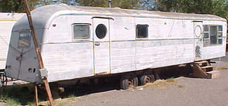

homnspector Posted October 4, 2005 Report Posted October 4, 2005 Does anybody know if attachment of a deck directly to a mobile home is allowed? Do the decks have to be absolutely self supporting? Thanks in advance for any help
Bill Kibbel Posted October 4, 2005 Report Posted October 4, 2005 Did the deck have wheels?[] I don't know the answer, but common sense would say that attaching any permanent structure would render the home non-mobile. I Never inspected a mobile home. Are there any that have been designated historic?
homnspector Posted October 4, 2005 Author Report Posted October 4, 2005 Well heck yeah! Download Attachment: homepageshot.jpg 18.26 KB I guess technically I am talking about a manufactured home or doublewide.
